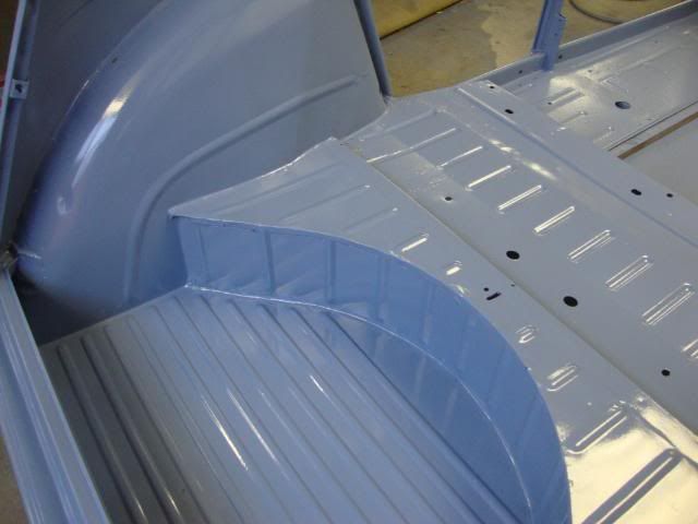

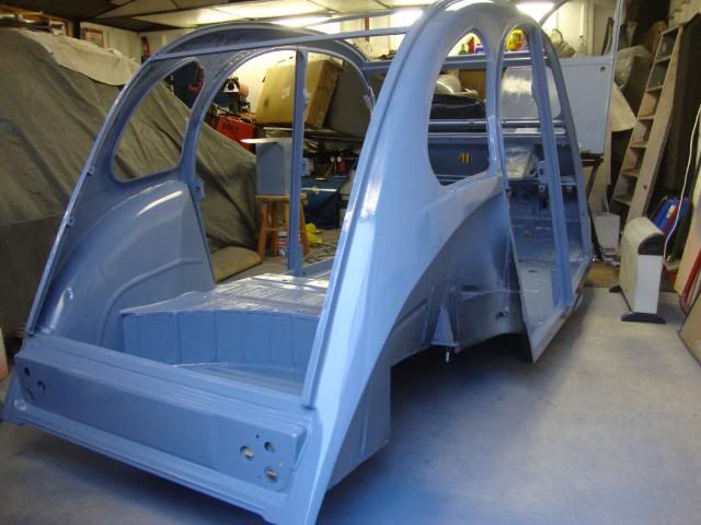

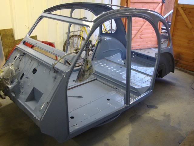

Well it's been a while but I promise I haven't been slacking.
I've been painting and it's been a bit of a challenge.
The main problem I had was orange peel. Lots of orange peel. The man from Del Monte would have been proud.
In Mr Nails wonderful instructions he says to flat back with 1200 grit ready for the next coat. I had to go down to 600 grit to make any impression on the craters I'd managed to spray.
I spent an evening playing with my spray gun and compressor and experimenting with more thinners etc and things started to improve. The final improvement was made by using some proper top quality high gloss thinners.
I'd now thoroughly recommend blowing the extra tenner on top quality thinners.
Anyway, some pics....
Still got many, many hours of flatting, swearing and polishing to go until I'm happy with it but it's turned out pretty well in the end, thankfully.
