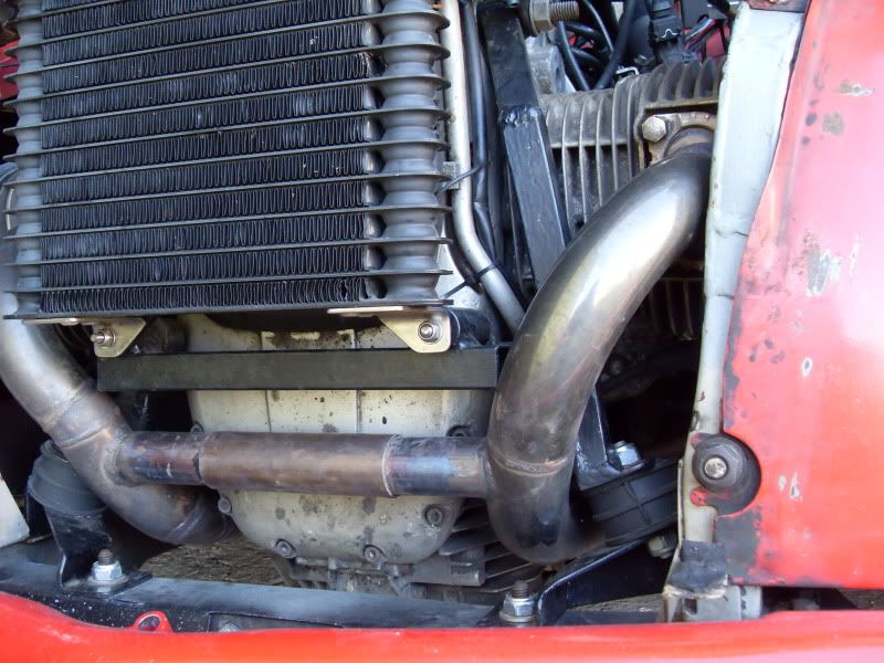

Post Re: Yet another red spesh...
Hi Russ, good to see you're making progress, it must be a pain in the ass when you've got to keep putting it back together to go home. Looks like you've got your motor sitting very low there, mine is quite a bit higher and fits under the bonnet ok. The bottom of the engine's front cover is about level with the top of the cross member.
http://i686.photobucket.com/albums/vv22 ... C10746.jpg
I think my engine must be further back, I can't find a good picture that shows the exact distance between the engine and cross member, but there's at least enough room to get your hand between them, you can kind of see from this view.
http://i686.photobucket.com/albums/vv22 ... C10515.jpg
I'm surprised it's so difficult fitting it in, I never tried, but I assumed the 2cv 'box was significantly shorter than the LNA. Your adaptor plate's a bit thicker than mine I think but only about 10mm. Did you check that measurement I gave you from the back of the motor to the bulkhead? I can't remember what it was now, but it must be in a PM somewhere.
One thing I wish I'd done was have a set of downpipes to hand when making the mounts, then perhaps I wouldn't have needed to modify them so much afterwards.
February 4th, 2011, 1:46 am
That's interesting. I'd saved a couple of your pictures onto my iPod just for reference when I was at work, but it wasn't clear enough on a small screen. Seeing that top photo it's obvious yours is a LOT further back than mine, and much, much higher. I regret it now, but I never tried the bonnet before I stuck it back together. I reckon it's going to be touching or close to it.
I'm interested to see if the boxes are longer, I'd have thought the LN box would be longer than a 2cv one, Something's obviously different between your car and mine and I can't believe it's the adaptor plate either.
Having seen that photo of your exhaust I'm a bit worried. I did a lot of assuming when I put it in last week, and one of the things I assumed was that yours must have been sat quite low in the chassis, and that it would be possible to get the exhaust out and between the head and chassis. It's now clear to me that it's going to take a seriously tight bend to get it to miss everything. I might raise the engine up (I'm going to have the mounts lasered about 50mm too long so I can adjust the height when I weld them together) which means I might end up cutting a hole in the bonnet. That's something I'd like to avoid, but unless I can see a better way round it, then that's what I'll do.
Are you still making exhausts up? Do you think you could make me a couple of downpipes? More than happy to pay the going rate of course.
