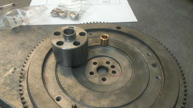

Progress! Crank spacer now machined and bush, next step is to modify the bolt size and pcd of the 2cv flywheel.
Still looking for either an LNA or Visa bell housing and shaft if anyone can help?
