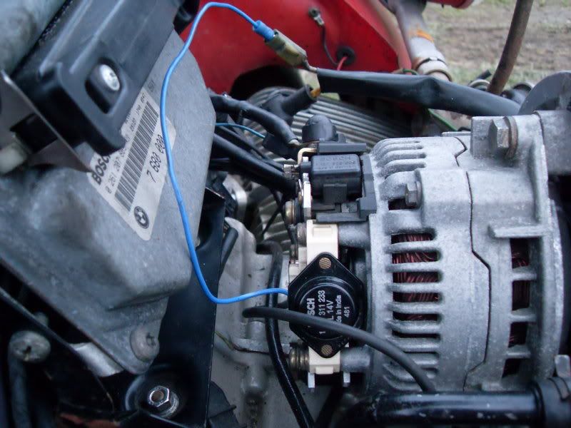

An update on activity, I hesitate to call it progress. I butchered the built in regulator and soldered a wire onto the terminals, then refitted the 2cv regulator and connected the wires up. A bit untidy but I'll redo it when I'm happy it works.
It's now overcharging... :roll: But I know why, there's about 0.5v drop in the feed to the regulator, I need to check out the fuse box and the ignition switch sometime to see if I can find it.

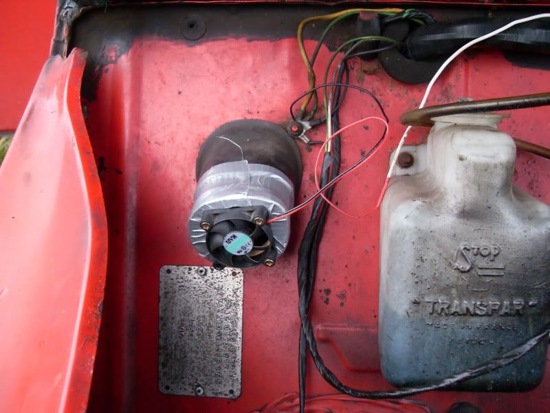

This weekend in an attempt to have some sort of demister, I've fitted a very small computer fan. It's a massive 40mm diameter and 0.9watt. It was chosen purely on the basis that I had it in the shed and it was easy to fit. I was quite surprised that it actually creates a noticeable draught across the screen, so hopefully it may also have some demisting effect. In keeping with the duct tape spirit, it's mounted with only three screws because that's all I could find in the right size, and the power is via a bared wire stuffed under one of the spades in the fuse box.
You don't need to disable an internal regulator - if there's two, all that'll happen is the one set at the lower voltage will control the charging voltage - because the higher-set one will never "see" the voltage at which it starts to do something.
So if your internal reg is putting out 14.5v, and the external would limit to 14.7v, the external will just see 14.5v, shrug, and pass it straight through.
If the internal reg is putting out 14.7v, and the external limits to 14.5v, the external sees 14.7v and caps it down to 14.5v, just as if it was being passed an unregulated 17v.

Post Re: Joolz's Red One
Not that easy in this particular case I'm afraid. Firstly the internal reg was undercharging, it was capping the voltage at under 14v and would keep doing so as long as it was connected. Also because the alternator is self-exciting, the voltage seen by the internal regulator is directly from the alternators output. That feed needed interrupting in order for the external reg to have any effect
