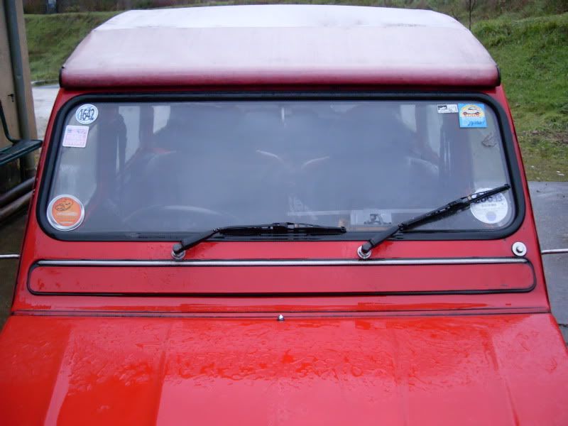

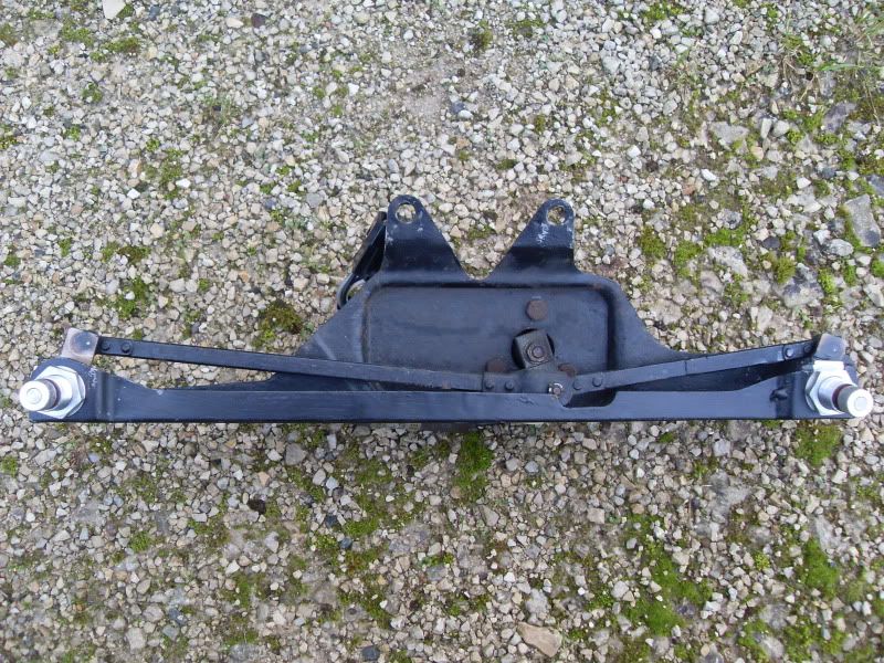

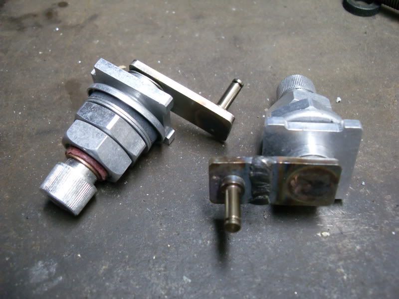

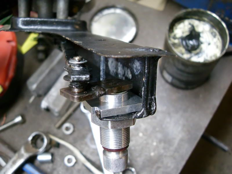

The wiper spindles have been leaking water for years now, so I thought it was finally time to splash out and buy some new ones. I went with the slightly pricey £45 each ones from ECAS, but they are very nicely made. Now I can't be arsed to write how to change wiper spindles instructions, but like much of my car, the wipers have been messed about with, so I thought I'd share the details.
I first did this with the old spindles quite a while ago, but didn't have any pics, so this time it was just the spindle that needed modifying.
First thing I did with my brand new rather expensive spindles was to cut the arm on one of them, and weld it back together 3mm shorter (Edit, this is perhaps a bit much, if you're giving it a go, try 2mm). I balanced it in a pot of water while welding, to avoid burning any O-rings that might be in it.
Before fitting them I soaked them in warm oil, and gave it plenty of time to seep into the bushes.
Either side of the spindle with the shortened arm I've welded in a pin to ensure the arm cannot go over-center, iirc they were a couple of nails, or pop-rivet shafts.
There's also evidence of where I previously adjusted the length of one of the linkage rods, but I can't remember if it was longer or shorter.
So why have I done all this? In conjunction with cranked(bent in the vice) wiper arms, The wipers now park at the bottom of the screen and still wipe all the way to the A-pillar. The originals look silly to me, why would you want them to park in the middle of the screen, what were Citroen thinking? :lol:
I'm now going to stoop to a new low in sad geekiness, I'm posting a video of windscreen wipers... :oops: Much to my disappointment, I can't embed it. So have a static pic, the link to the video is underneath should you feel the need. :roll:

As usual, nice work. But, and I really hate to ask this, are you not a little OCD about the passenger side blade not sitting on the windscreen rubber?
No, because I know it can't. It sits in the best place it can. My work here is done!

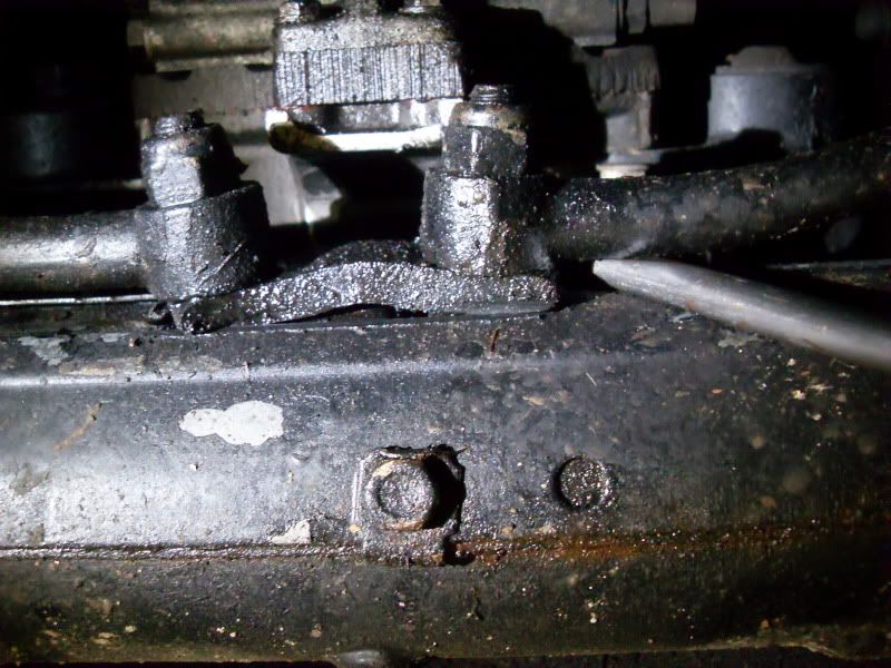

How much play should there be in the steering rack? There's in/out (backwards/forwards) movement at the inner end of the track rods. If I lever the track rod forwards, the mark on the anti-rattle rubber shows how far it moves, probably about 2mm.
Rocking the wheels, it feels bad, and if both wheels are rocked at the same time in opposite directions, there's quite a pronounced forwards/backwards movement at the inner ends.
