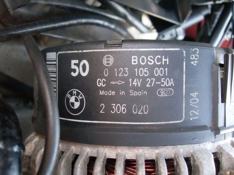

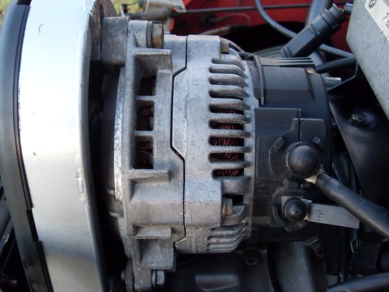

Ken, yes standard BMW alt. There are two different ones found on the bikes, mine and a physically smaller one made by denso which I think has a lower amps rating.
This is the one fitted in my car at the moment,
No remote regulator or anything like that, it's exactly as a modern car alt and seems to be a very common bosch type. The idea I had for increasing it's output was to swap it's internals for those from a higher rated unit of the same type. I found these on ebay and the similarity in appearance suggested to me that parts would be interchangable, it would just be a case of using the front casing from my existing one, so that it still mounted on the engine in the same way.
