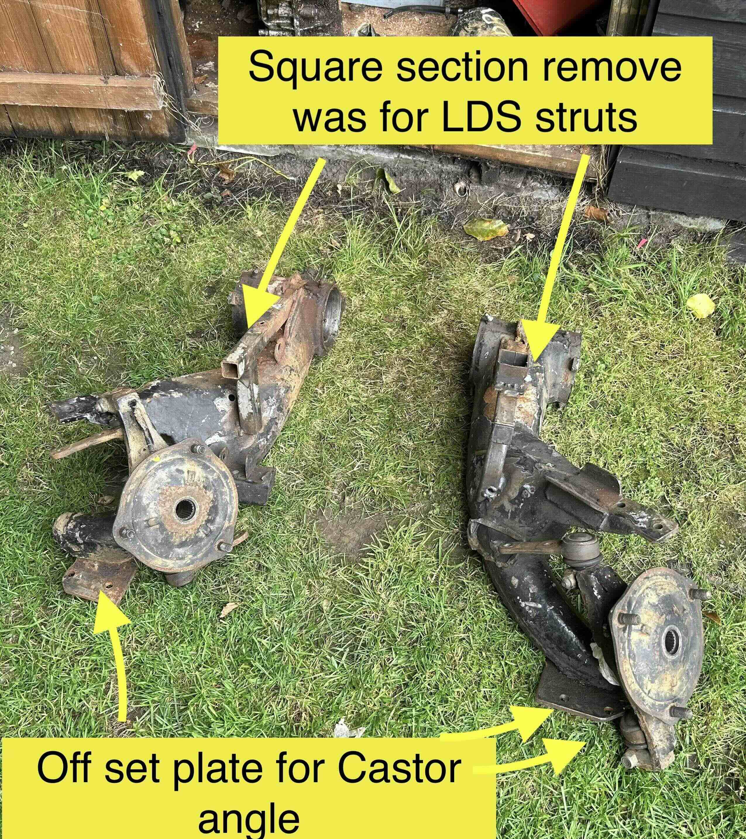

Post Re: Yellow Dyane
Maybe these arms see pm
