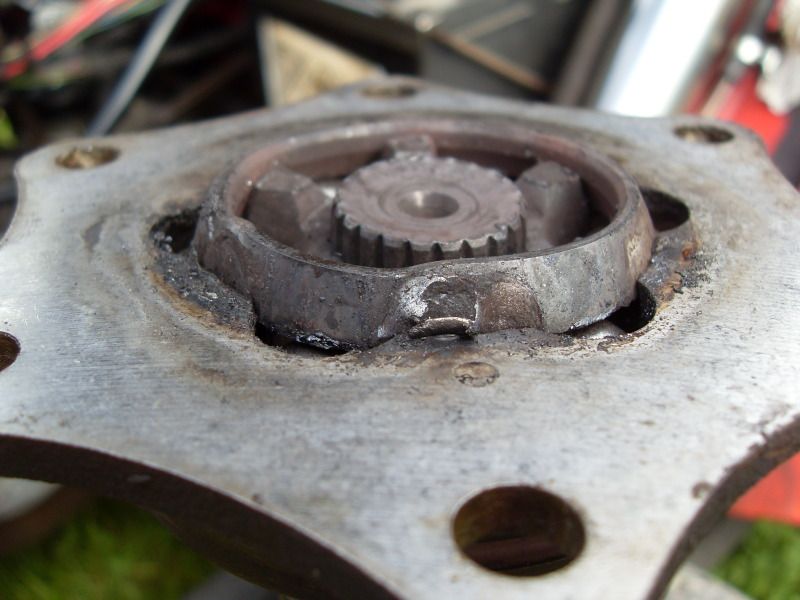

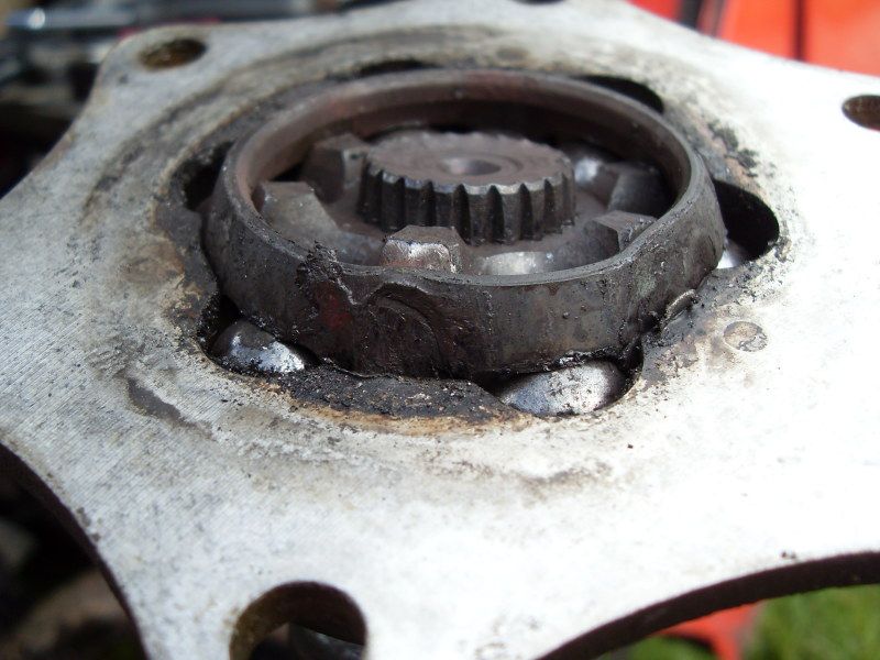

So I've been and dug another driveshaft out of the shed of tat and swapped it for the one on the car. The one on the car looked like this,
Looks pretty fuct to me, the smeary looking bits aren't grease, they're metal. I'm slightly puzzled by how it failed so quickly, I've seen plenty of cars driving around with split gaiters, that only become an issue when they fail an MOT. I don't think they've got that much angle on them, but perhaps I'm wrong. I can only assume it's something to do with the brakes heating them up so the grease is thrown off quicker and then they're dried out. But don't they use high temp grease?

Joolz,
grease for 2cv joints usually contains 'extreme pressure' additives such as molybdenum disulphide.
The only time a 'high temperature' additive would be of any help was if the assembly had been run 'dry' and started on that spiral of locking up and overheating which leads to rapid failure...
Have you checked that the plunging splines aren't bottoming out and putting end load on the joints?

You mean the sliding joints in the middle of the shafts? They shouldn't be, one of the things I was careful about was getting the overall gearbox width the same as standard. Plus I usually over compress the shafts without any trouble while manoeuvring them into position.

Joolz wrote:
Odd,
ill refer m'lud to the previous picture
:lol:
Those type of UJs usually wear the ball track, because yours has been forcing the cage against the body i think Ken is sniffing round the right area to look at.
As soon as the grease fails the surface of the metal becomes scuffed and that makes it worse and a very rapid failure happens
my t25 VW van used to kill inner UJs going up the hairpins on the Bealach when i worked in Applecross
July 5th, 2012, 8:18 am
