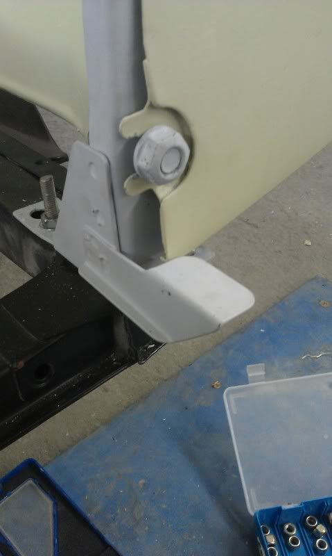

P.S. Does anybody know what this protruding lower section of the lamp bar is for, and do I need it. I think it's a support for the front bumper but can't remember. I'm fitting 50's bumpers if it makes any difference. Thanks..

I think it sits under the bumper, you can get rid of it and nothing bad will happen.

Post Re: My new 2CV, running restoration. In theory..
I would kill for skills and facilities like yours. This cars going to be superb.
Thanks Russell, having the workshop and oven is a massive help.
And cheers re; the bumper bracket thing. It'll be getting removed in that case.

pbp,
don't they provide the support points for the front end of the bonnet?
I know when I've been working with cars which have no front bumper, I've fitted a couple of rubber buffers ( aka walking stick tips ;) ) onto those brackets, otherwise the bonnet ends up almost sitting on the light bar.
If you haven't got the little rubber buffers fitted to the front outer edges of the bonnet, there can be contact with the wings as well, which wouldn't do your new paintwork much good.
