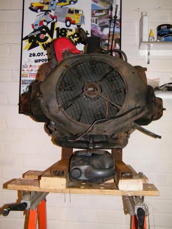

What I did remember to bring home was the engine. It's been sitting out in the weather for a while and it's only a matter of time before its fubar.
I've only half made the engine stand so it's currently on the WorkMate, which isn't quite strong enough to instill confidence. It's the best I can do until I've made a proper engine stand/trolley thing for it. As mentioned, I don't have a pot to piss in so with any luck the engine will just want a bit of tarting up. What it certainly needs is new manifold studs because they were not coming off. I attatcked them with a grinder and a chisel and now that's that.
I've left it tonight draining the oil as best it can and I can start taking stuff off it tomorrow and assessing what to do with it.
