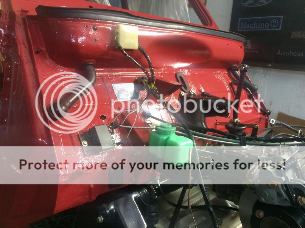

Post Re: The Dirty 'D'
Wiring time... all very easy thanks to the factory colour coding....
Detailing parts and fitting up.... great fun...
