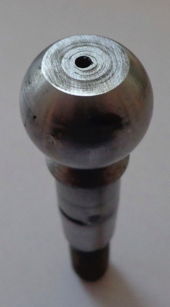

Agreed the inner ball-pins, don't wear that much, but the guide ring does.
By greasing through the ball-pin, the surplus grease spills out and lubes the slide at the front.
Have also a small hole at the back so the guide ring gets grease as well.
Did mine in a lathe with a carbide drill(S)!, takes a lot of time, just drill 1mm at a go and back the drill out...
Also newer knuckles are not as hard.
