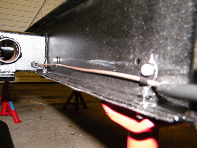

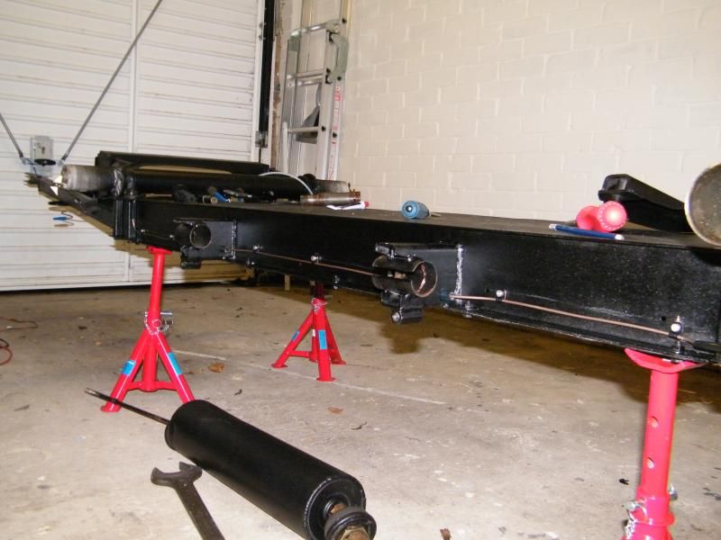

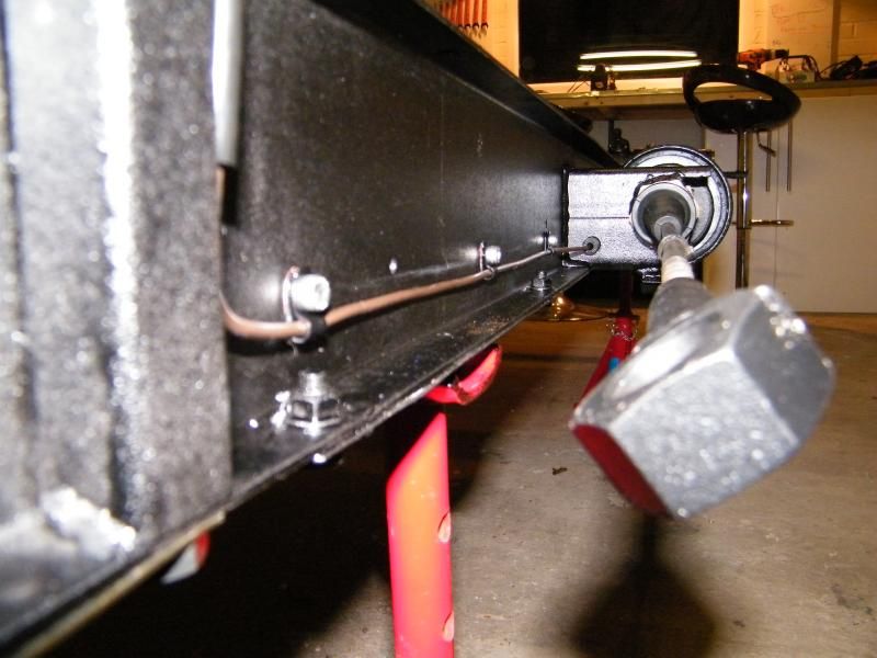

Bending them isn't the problem now. Straightening them is the part I'm having trouble with. I simply cannot get the 'straight' runs of pipe straight. How is it done? I feel like I'm missing an obvious trick here.
November 23rd, 2014, 7:52 pm
How do you do it? Is there a tool or something you can buy? I've been out there an hour or so and no amount of massaging or tweaking will get the brake pipes straight. I am now nursing very sore fingers and am overcome with an almost uncontrollable rage.
This is honestly the best I can do with bare hands.

There is a tool but it won't work 'in situ' on a 2cv.
November 23rd, 2014, 9:06 pm
I'd be happy with calling that straight. Even if there was a tool that'd work I doubt it'd make them better than what you have there.
