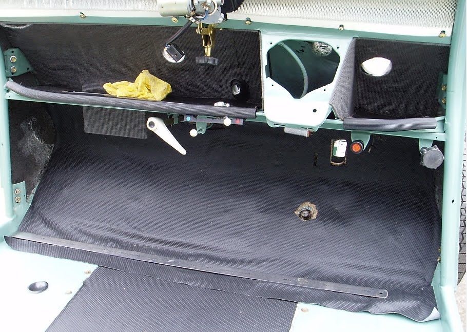

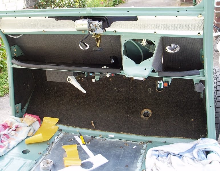

Readers of this blog may have unfortunately missed out on many of the posts that I have done during this rebuild due to them originally having been posted on the 2cvGB forum. One of the posts that you might have missed due to this related to the fitting of soundproofing to the car as shown above, which when fitted was given a top covering of rubber matting (below) mainly to prevent and moisture from the odd drip (all 2cv's allow the odd drip of rain at some time) becoming trapped in the felt below.
Once the two layers were glued in place the master cylinder was attached and the pedals were fitted. The final bit of floor covering is the standard fitment rubber matting which were then added. Now here's the thing, the seats are not yet upholstered and so not attached to their floor mounted rails, so in order to bleed the brakes I simply placed the drivers seat in the car and sat on it. This was quite a wobbly business as the harder you pressed the more the seat moved, or rocked backwards!
Now bleeding brakes on your own is not a pleasant task, but with the additional stress of seemingly going nowhere with it, exept in terms of falling backwards off the loose drivers seat each time you press the pedal it soon became impossible, given my temperament, to remain calm. I lost the plot - big time!
After a period of well needed sleep I returned to the car and fixed the drivers seat in position, it has to come back out to be trimmed but I couldn't contemplete rocking about the place on the unattached seat again as I had been doing. It was that one thing revealed what had been wrong. With the seat firm I was able to get better purchase on the brake pedal and found that, in actual fact it was possible when pressing very hard to gain another 15mm of travel on the pedal. The aforementioned soundproofing felt had prevented the full pedal motion from taking place, and the 'rocking' chair had prevented me from noticing, as it fell backwards before that point!
So, using my old motorbike's solo brake bleeding tube the brakes were bled satisfactorily, they are still slightly spongy first press which I'll see to later, but as with my first Kawasaki back in the 1970's, what seemed at the time to be the last straw has now become another setback conquered. 8-)
