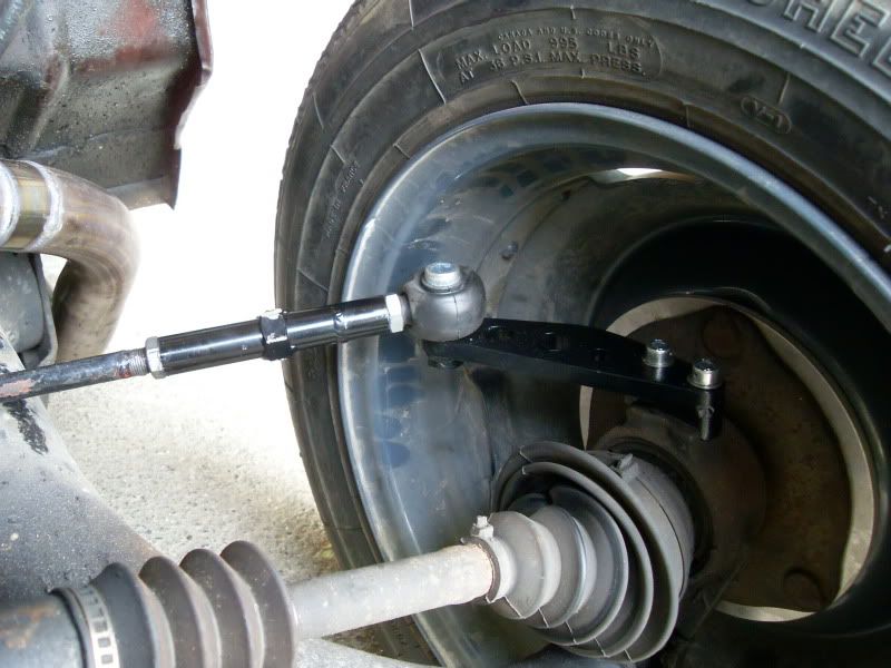

Russell,
Joolz may have lowered the outer end of the track rods, but I don't think that will have any effect on the Ackermann setup, since the relative positions of all the components are still correct in plan view.
In fact, since the car's already lowered, it's probably lessened any (very slight) tendency for bump steering to occur...

ken wrote:
Russell,
That's kind of what I was asking, which answers my question. Thanks.
November 14th, 2011, 9:55 pm
Post Re: Joolz's Red One
Yes, when I cut out the new arms I was careful to make sure the relative positions of the mounting bolt holes and the ball joint were the same as the original. The 30mm difference is in height above the ground(assuming the kingpin was vertical), and is because the new arm is flat, unlike the originals which curve upwards. There's now a fat fingers clearance between the track rod end and wheel rim. I did consider making the arms shorter to quicken the steering but originally decided not to. However when it came to drilling the holes I did move the the ball joint a couple of mm towards the kingpin, it won't make any noticeable difference, but I just couldn't help myself! And note I moved it directly towards the kingpin (which is some way offset from the mounting bolts), so the ackermann will remain the same.

Hi Joolz,
that's how I understood it as well, they've built in a factor of safety by limiting the tensile load on the bolt to 75% of its proof stress.

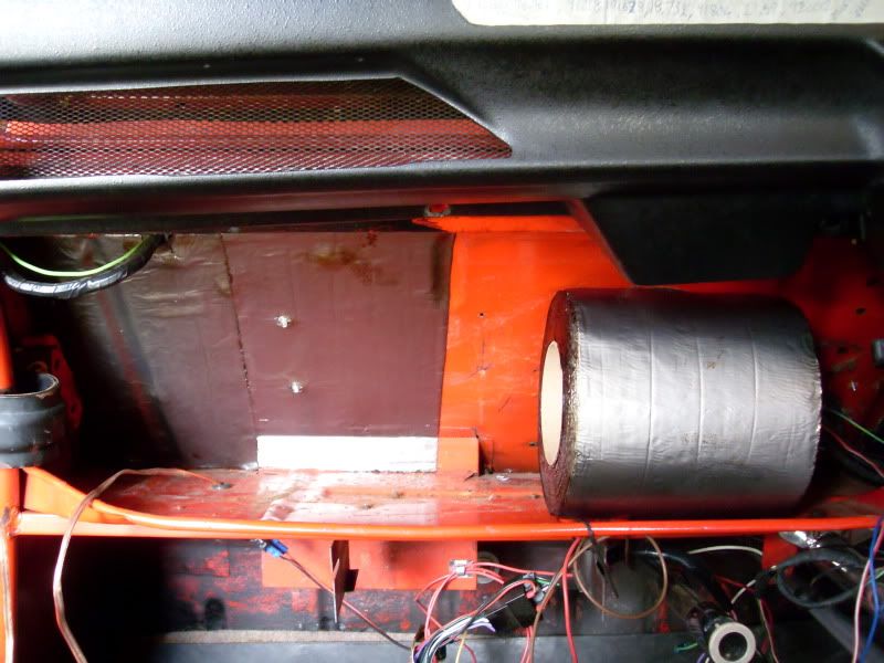

Other news I found this in my fotobukit, it's supposedly sound deadening but is suspiciously similar to bitumen based roof flashing. I actually stuck the first bits on last summer (nothing like keeping this up to date) and they haven't fallen off yet in either the heat or cold.

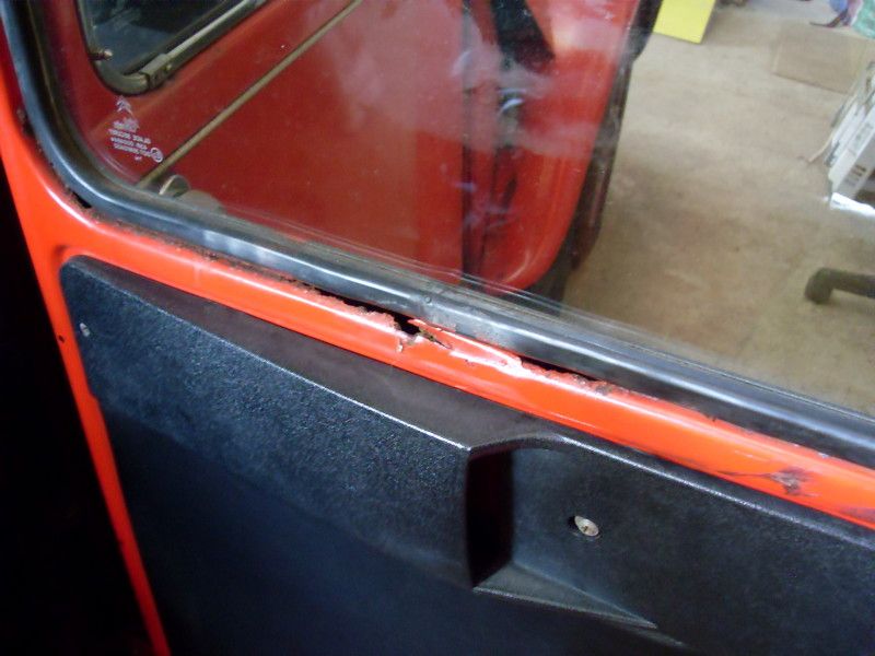

And then just this weekend I've been repairing the top of the passenger door. Horrible to weld, so thin and the seem is full of rust. A bit of free advice to everyone, don't ignore the little patches of rust where the window has scratched the paint off, they get worse. And secondly pour some oil/wax inside the doors and tip it into all the seams, they are rusting. Oh and in case I wasn't having enough fun already, three of the four screws broke when I removed the glass, and I had to drill them out.
