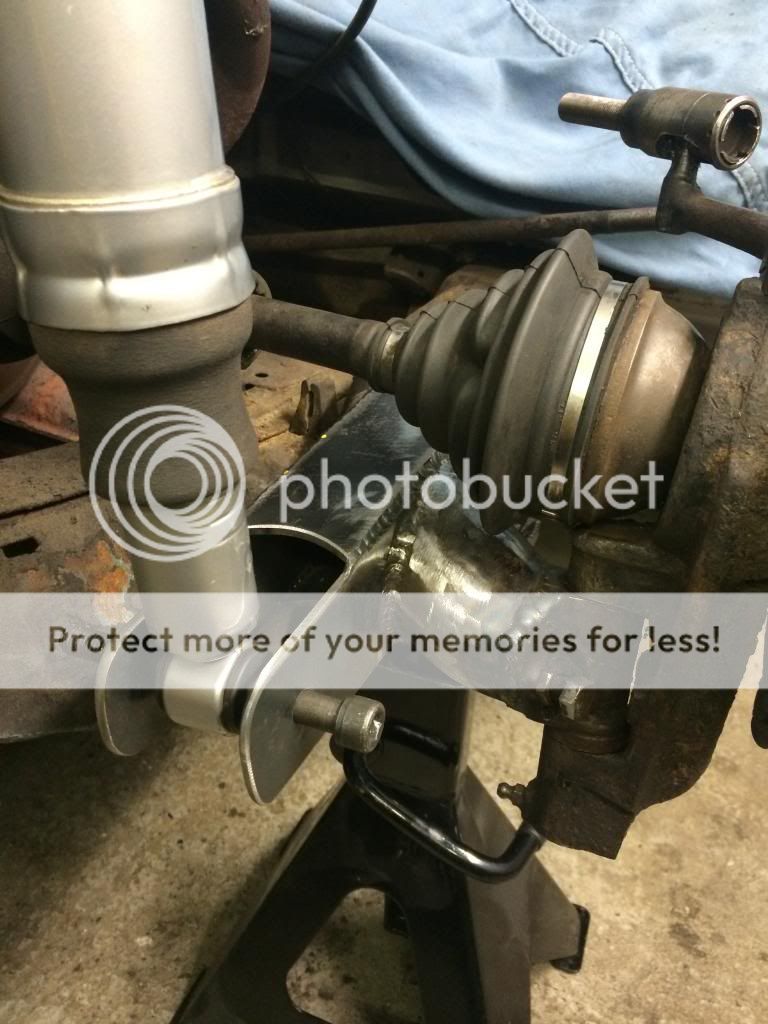

Once the drive shafts had been cut down the mounting for the front air shocks were made up and welded into place..
As per the rear mounting plates were made up to bolt down onto the chassis rails......
www.evilbens.blogspot.com
May 18th, 2014, 5:32 pm
Posts: 328
Location: Cornwall
Post Re: The Dirty 'D'
Then bolted into place and the notch made for the drive shaft....
With the frame work added to the plates for the upper shock mounting, this frame travels under the starter motor to the other side and this cross brace also bolts into place...
Working out the angle for the top mount proved to be a real pain, but i got there in the end....
