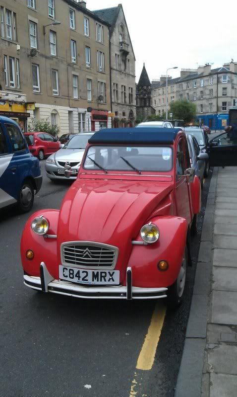

The last burst on the bulkhead was inspired by this 2CV that I spotted parked in Edinburgh last weekend. Does it belong to anyone on here?
