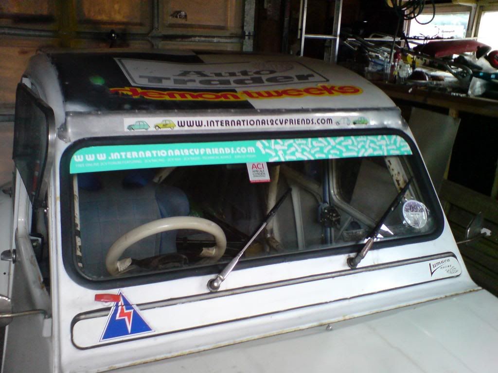

I bolted all the front end back on her today and made sure lights etc work ready to take her out for a spin. But then decided to take Seth instead-the sun was shining and I didn't fancy cooking in a tin top!
MOT expires tomorrow so gonna fit a shorter steering column and a few other bits over the next few weeks, she's booked in for MOT on May 1st so gives me a bit more "tinker" time. 8-)
Put my new sticker on too. Cheers Simon. 8-)
