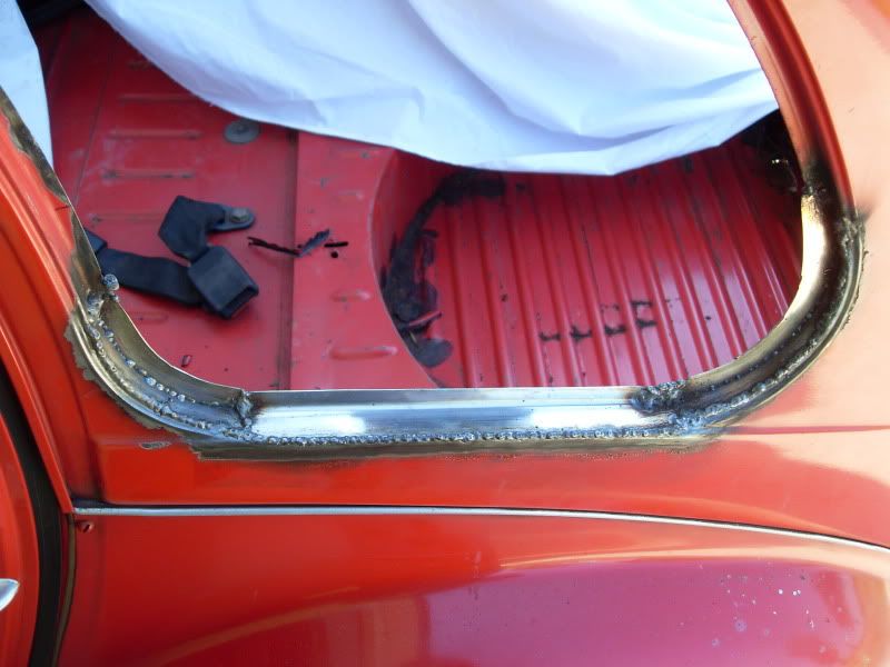

Bodywork. I've put some new metal in the rear window. I'm not under any illusions about this looking nice, I'm hoping some careful fettling with the grinder will leave it looking alright. The bits in the corners that look like they're only tacked are actually welded on the back. Constructive criticism welcomed. The curved bits still need some shaping, there was so little left it was hard to wok out exactly how big they needed to be. And it's only been done with stainless because there's a lot of scrap bits of it around here.

Once that's been ground back you'll never know. Except it won't rust again.

Agreed. Very nicely done Joolz.

Re: the window frame,
I'm sure it'll be alright when it's finished and hidden by the rubber, but the only good thing about it is that I've pulled my finger out and done it. Unfortunately proper work is keeping me too busy to finish it at the moment.

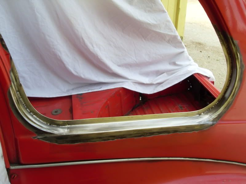

A couple of hours with the grinder, wire brush wheel, abrasive wheel in the drill, and even a file, I think it's as good as it's going to get. There are a few pin holes and low points in the weld, but I've put on a coat of brush primer and hopefully once it's rubbed down it'll help smooth it off. The temperature's in the mid 20s here and the paint was drying on the brush, so it's full of brush marks and looks a bit crap. When it goes on a bit thick it can take a long time to harden properly, which'll make rubbing it down difficult.
When it cools down a bit I may thin the paint down and put on another coat, to try and fill the brush marks in the first.
June 13th, 2010, 6:57 pm
