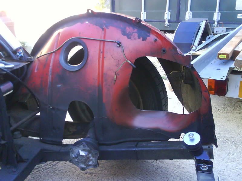

Because the engine's quite tall the cylinder heads only just fit under the wings, both vertically and longitudinally. But it does mean that as it is at the moment, the engine is higher than the box, so lifting the back of the box might not do too much harm.
This was the first trial fit, it's now got about 1/2" of clearance.

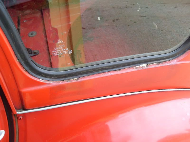

Ever since I bought the car it's looked a bit scabby under the rear side windows. That didn't really bother me, but it leaks a bit and that does.
See doesn't look too bad at first glance,

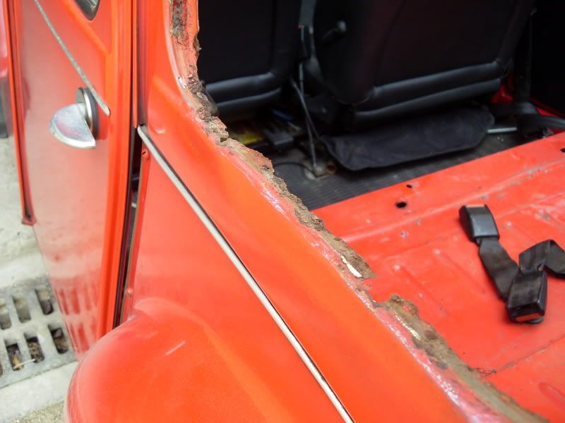

But I knew that there would be horrors lurking underneath the rubber, and I wasn't disappointed. Now I remember why I've been avoiding this for 6 years.
And once I'd cut off the rusty bits there wasn't that much left. At about this point I started wishing I had a repair panel.

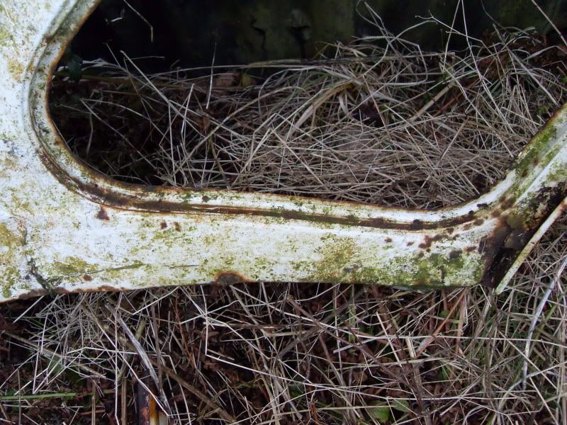

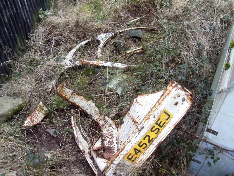

There's actually an old shell at home in the undergrowth, and as you can see it's seen better days,
Although ironically it's window frames are in far better condition than my car. They're just not quite good enough to use as a patch. :evil: :roll:
And to save anyone(Neil) putting the plate through DVLA's vehicle enquiry, it's been there @15 years.
