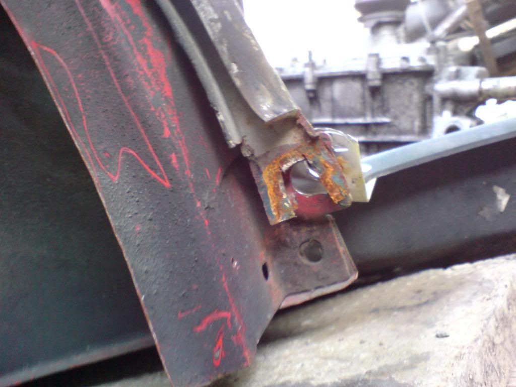

No worries, mines just a cut down headlamp bar slotted to fit the "feet" of another old h/lamp bar. Just uses the headlamp bar to "brace" it as you take it all off in one lump. :geek:
I only took it off that way because I couldn't be bothered to cut the tiny cable ties at either end of the spoiler! :lol:

Cheers Russ, that's a nice quiet gearbox fitted in the racer now. I've even bothered to put the exhaust back together with a bit of care so that's also quite a bit quieter too. 8-)
Fitted the new flywheel too
As for the "one-piece" front end, here's a couple of photos to show the simplicity Russ

Apart from the wiring, and relocating the coil, I guess you could weld the wings onto the headlamp bar, and the A panels onto the wings, then do something similar to what you've done there with a bit of 25x25rhs and 30x30rhs sleeved with a bolt through, so you just undo them, and the bulkhead and rearmost nuts and it all comes off.
I'm well tempted to do something like that.
