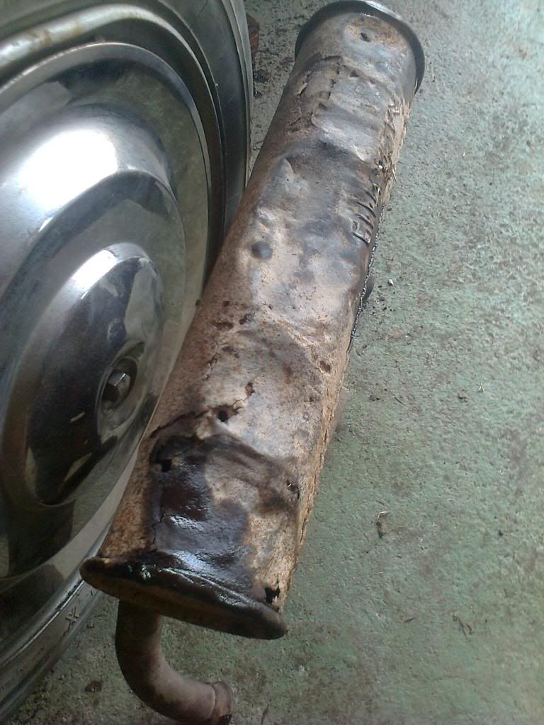

banjo tank done mate. easy peasy, repainted and its back in and lovely :)
the cross box...blimey they don´t leave much tolerance to get that thing in and out do they!, I told you the old lady driver from before was into off roading!....look at this, must be difficult to do and standard height surely
while its out i´m degreasing and cleaning up everything (and repainting the tin work with heat resistant paint up to 400degrees c, should be ok no?)
finding all sorts of new shapes and colours under the brown and black

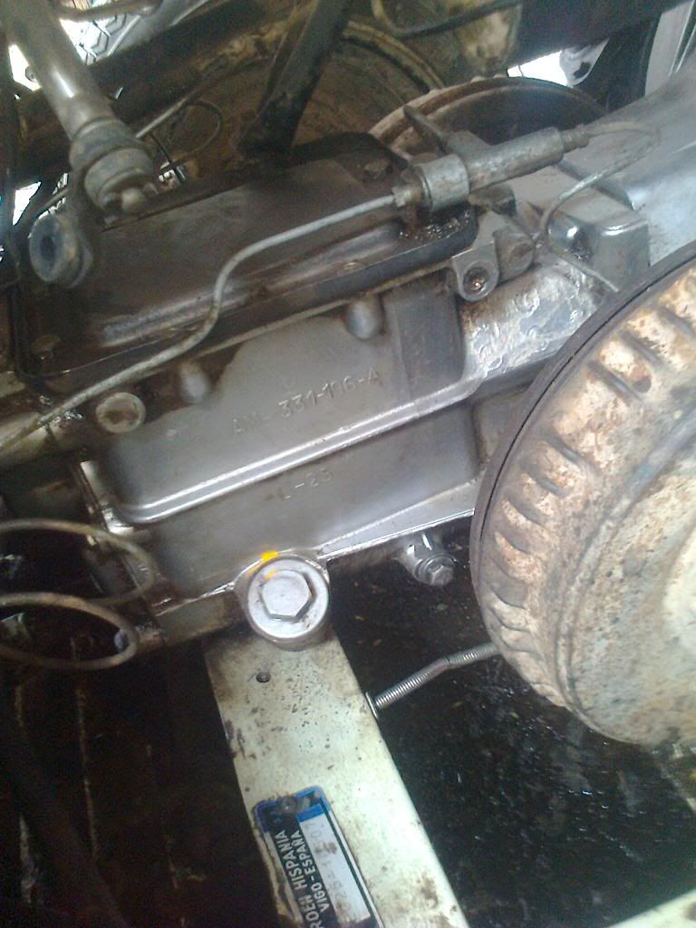

found what I assume to be the gearbox filler plug (with another mysterious yellow cross), but the bolt at the right of it? whats it for, theres one on the other side also and they are loose or missing, so not the drain plug, any ideas?

Post Re: sidney has entered the building
That's for hanging the exhaust crossbox from, so the exhaust doesn't take the weight. There's one the other side.
But - that's an "old-style" box. Good ol' Vigo, using up shite that France had binned years before. Those boxes died in the 2cv way before your car, I'm sure. Anybody know exactly when? Cats's site doesn't say.
