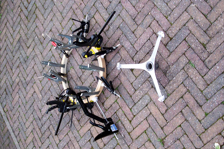

than i did rebuild the wooden steering wheel. It was completly falling apart by humidity and woodworms. But luckily all needed parts as special screws were still there and one connection to the spoke was still intact so it could be copied. It was glued by several sheets of plywood and than cut round edges with a router.
