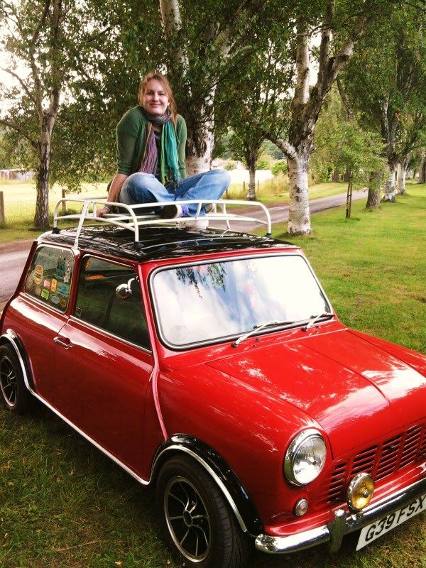

Lenny wrote:
Can we have some more photos of the girlfriend please?
+1
Oii!
Ok, but let me show off another of my cars too..

I had a set of those Dunlops in 10". Cost me a bastard fortune to have refurbed. Interesting idea to have a pick-up front panel, not sure it's what I've had done, but it's different. Wouldn't mind another Mini but I get poxed off enough driving my 2cv over bumps. A Mini is an advanced form of masochism.
April 24th, 2011, 10:08 pm
Post Re: My new 2CV, running restoration.
P.S. Cheers for the pics of the missus. If my bird sat on the roof of my car I'd be bloody livid.
April 24th, 2011, 10:10 pm
Nice wheels, mine are 12", rare as you like, banded steels on the way though.
She did dent the roof, and yes I was bloody livid. Had to repaint it, had a dent on each corner. Masochism is underrated.
