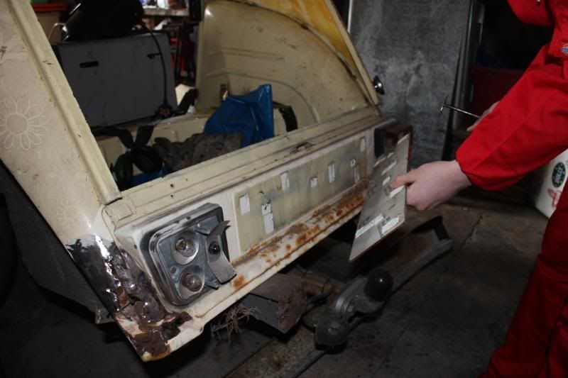

Milde update. This Sunday's little bit of work.
My sister Kim and I got to work on Bella. Kim was removing the last of the trim that remined and any other bits before making the first attempt at removing the 'jelly bean' 3/4 window for repair. We consulted our "how to restore Citroën 2Cv" book which was totally unhelpful regarding this removal query.
Kim removing the lights and number plate that the previous owner/crazy had used adhesive pads to secure :?
Kim removing bits.
And the increasing pile of 2CV bits..

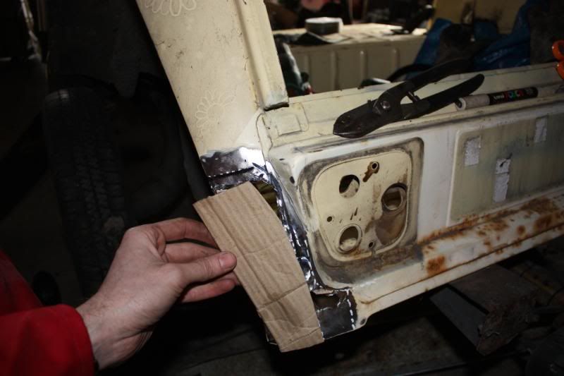

Meanwhile I set about getting the rusty corner de rusted.
Looking light

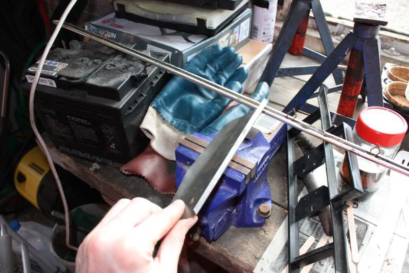

Starting to work on a template for replacement steel.

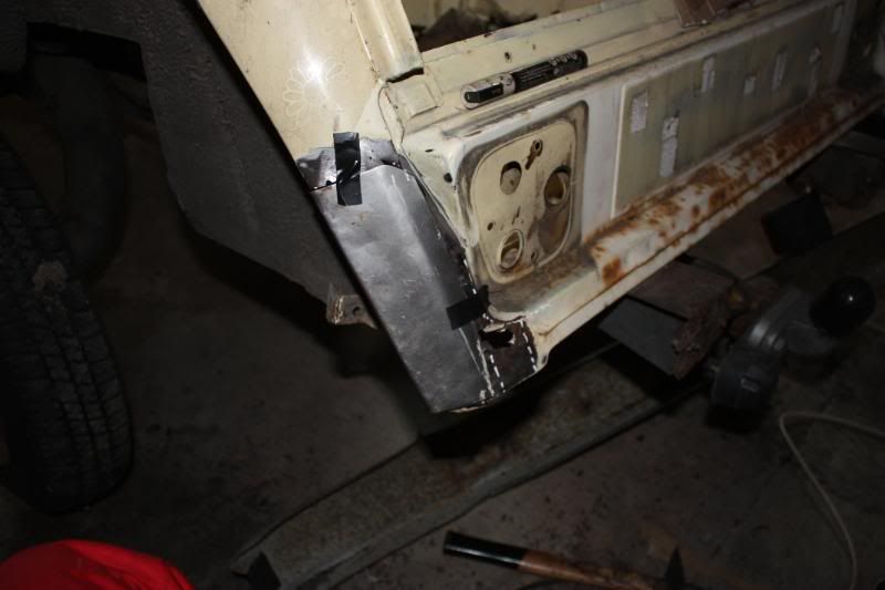

Cut out and forming a patch.

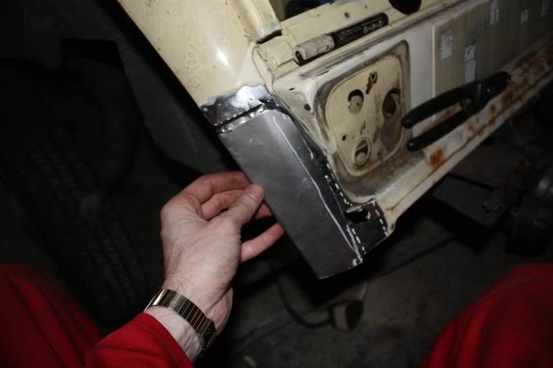

Initial fitting check. It is going to be fitted 'over' the upper and lower edges about 5mm overlap from where the body was cut. The existing overlap is hammered down to let the new patch sit at the same (or near enough) profile as the existing surface. The edge where the patch meets the wheel arch is to be folder over into the arch space for a better fit. The least neat bit will be where the patch and the start of the lights/numberplate panel meet where access is bad and I'll just need to do the best I can.

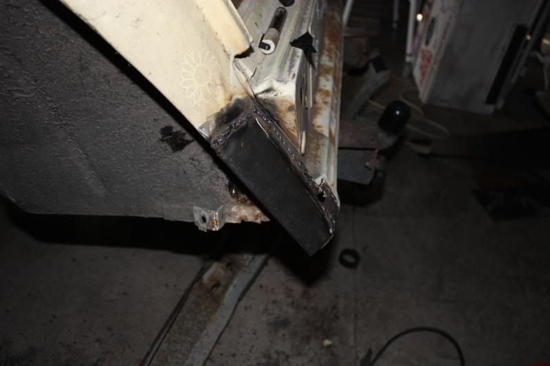

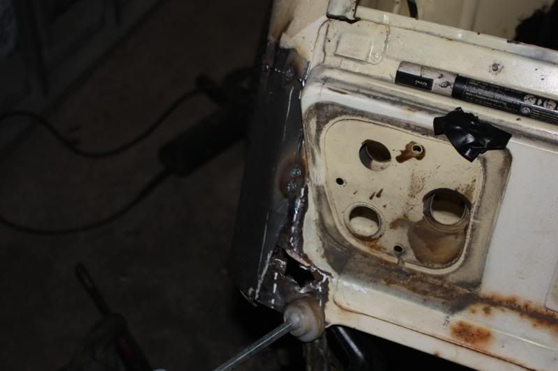

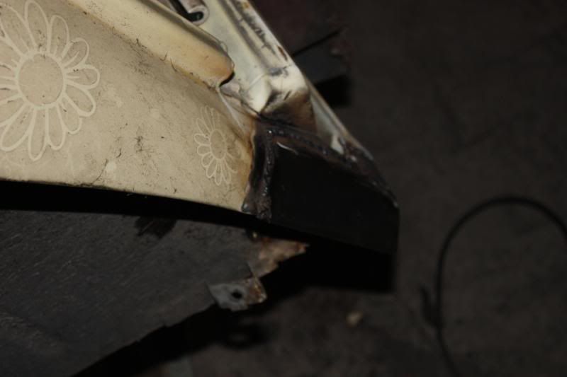

Began welding the little bit at the rear corner.
At first stuck on the new plate with some electrical tape.

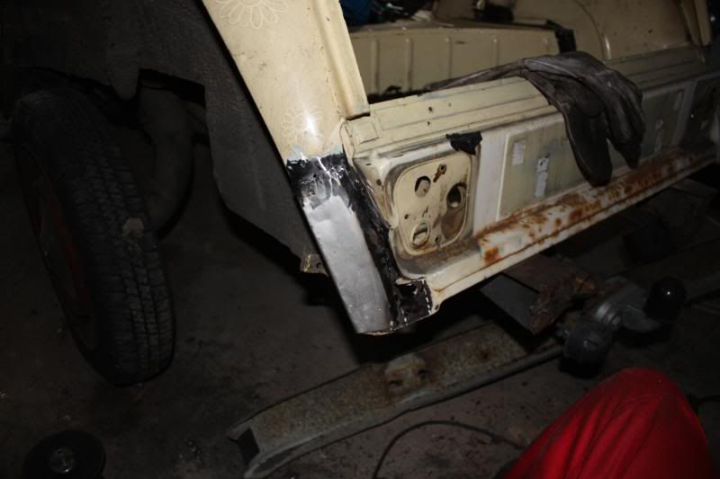

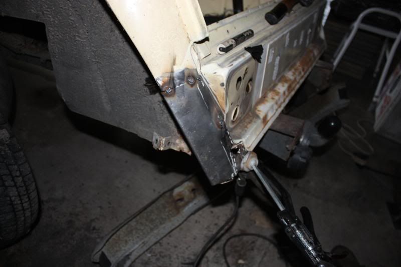

And after checking the fit one last time I decided I wanted it to sit in a little lower than the surface profile so some mild modding of the existing metal where it folds round to the inner wheel arch was done.
Then after I was happier with the fit, the first of the tags were, erm, tagged.
Once I was certain the arc welder wasn't going to blow holes in the tin snail's tin, I went on and sealed up.
next, back with the grinder to attempt to profile the messy weld beading flat and slightly below the finish surface. Idea is that when it's finished, primered etc, I'll use body filler to smooth it out before final paint.

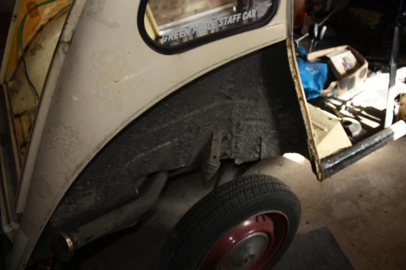

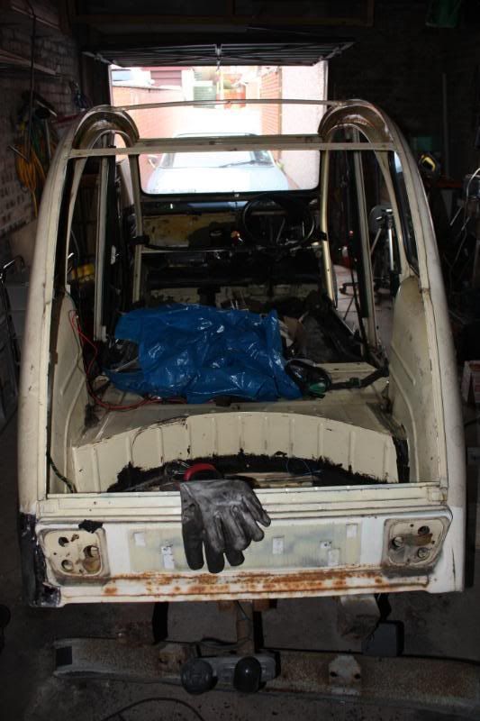

Finally, a plan shot of the repair side vs. the other side - I think the profile is turning out OK, and with the new bumper back on at some point, it's a fairly hidden area. We'll see how it turns out.
All for now - there'll be more exciting welding chapters to come!

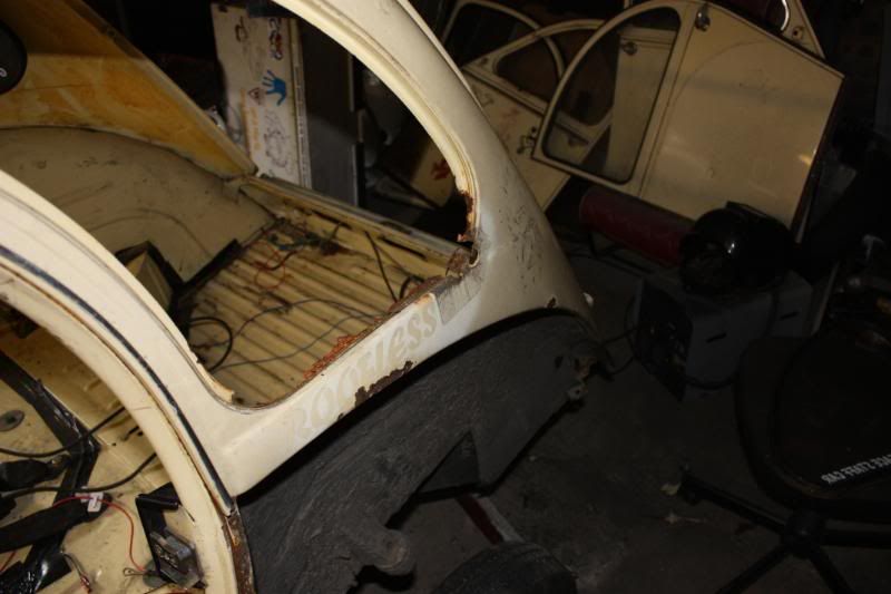

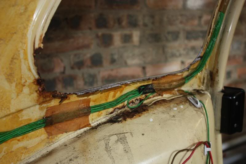

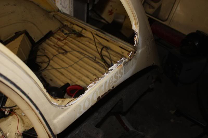

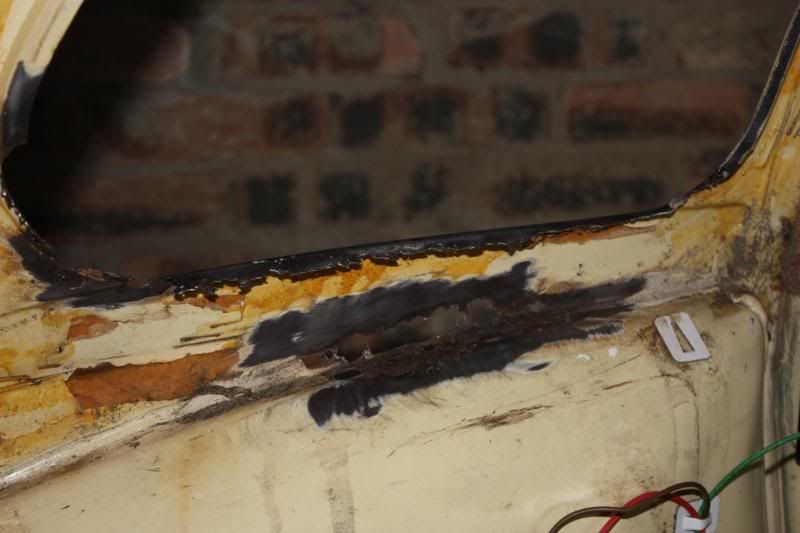

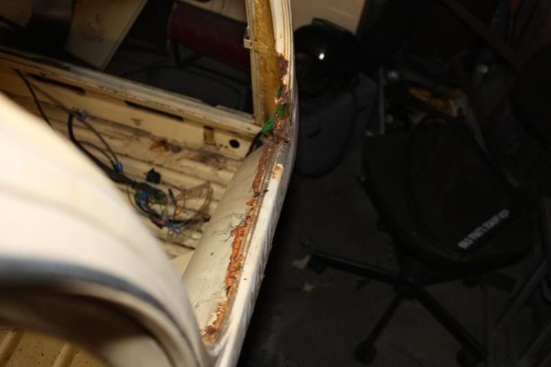

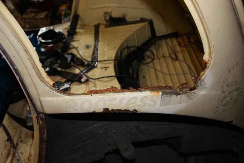

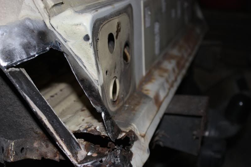

Mild update from this evening - I removed the 3/4 window from the car.
And saw how much metal was missing from the panel!
:?Zoiks :? :?

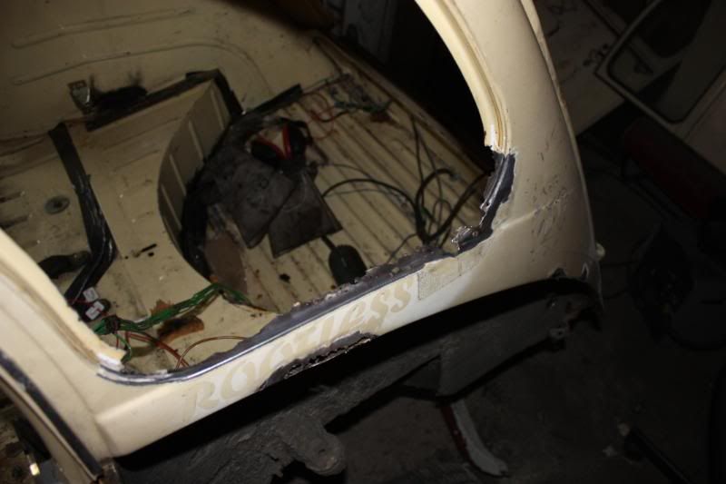

If I am going to try to re make this I wanted to note the profile if the lip and the line of the flat lower impression so I marked it out
So I set to it with a wire brush on the angle grinder to try to eliminate the rust and see what was left!
O dear, even less metal...
So, I'm now beginning to wonder if it's viable to repair this part or try to source a whole new 3/4 panel.
I'm going to need advice here - anyone?
On the plus side, the inner rear wings are very solid - even around the bump stop mounts.
--Graeme Mc
