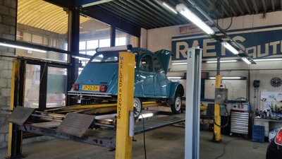

Posts: 2260
Post Re: AZL 1957
Passed at the MOT today. All clear i may drive for 2 years again. Nice picture with hanging wheels.

Posts: 2260
Post Re: AZL 1957
Thanks. It had a little play on the king pivots. Horizontally ??? Never seen that, normally it's vertically. The lower hole seems to be a bit oval front to rear...
