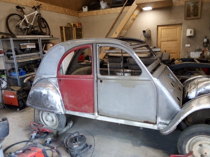

My AZ dates from june 1965, so it could be issued with 3 side windows, or with 2 on each side.
This one has original 3 side windows, but we decided to convert it to 2.
Now i have a question.
The place of indicator on the side near the rear door differs in these two cases.
What i need to know is where the indicator should be located when the car only has two side windows .
Could someone please measure the distance from the rearside of the B pillar , and the distance from the bottom of the sill, or bottom rear wing to the central hole where the indicator is positioned ?
Many thanks in advance

Dag Geert, The middle hole is 34cm up from the innerwing and 10cm (horizontaly) from the rear door frame. Both measured from the inside. Diameter 1 cm.

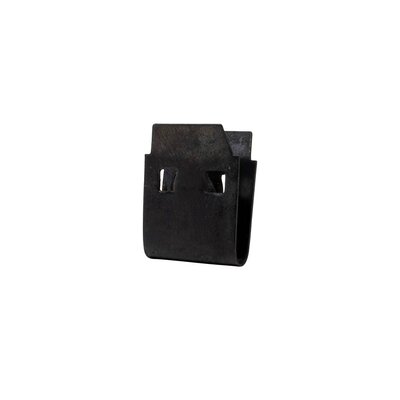

Before spraying the body, we put it together for the test. Now we come across a small problem.
How is that little clamp on the back of the rear mudguards fixed ? We tried to fix it,but we can't get it fixed properly .
March 5th, 2024, 8:12 am
Posts: 2196
Post Re: �1965 2CV AZ
It normally is hammered on from the bottom. Think of fitting the aluminum lining between wing and body first.
