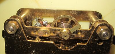

If i have faster clock speed i have to repair it.... :roll: :lol:

I've lost the key to wind it up :lol:

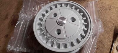

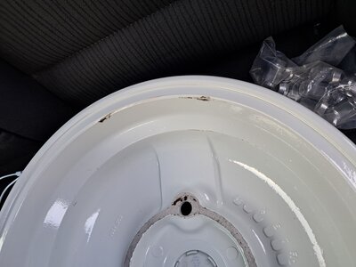

I bought some GS/GSA Alloy wheels for the Shed.
They won't fit straight off, as the trackrod end will foul the rim. This only happens when on lock, so the trackrod end is turning and coming into contact.
So, I will try a spacer. If that fails, I may need to see if there is enough metal to machine some off the rim. Though, I will look at the trackrod end as well.
The spacer will be the easier option, but means there is less thread on the wheel nuts.
Machining, I guess it's best to do all four wheels, so they are inter-changable.
Not sure about fitting to the back yet. :)
File comment: You can see by the black marks where it is fouling.

Just trying to make it a little tidier than it is. The trouble is, it keeps gaining on me! It's a bit like trying to polish a turd!
The fibreglass bonnet will help some. Though I do miss the bracket fungus that was growing out of the wooden one. :D
I think there is a little scope to remove 0.5 - 1.0 mm from the trackrod end. Doesn't have to be all the way round, and it's just on the corner. This will allow a thinner spacer on the wheel. :) And also keep the front and back wheels inter-changable.

Are AK trackrod (bit that bolts to the hub) arms shorter?
