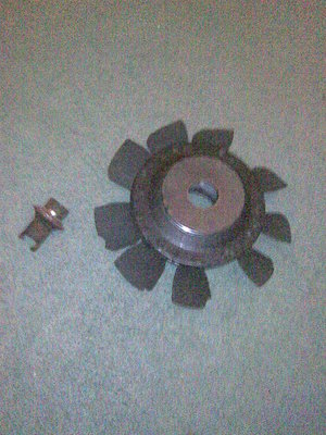

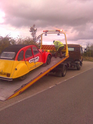

sunday morning left sheffield and made it to A14 near wood green, huntingdon where we started getting very hot found the fan broken! :roll:
worst part we missed sunday lunch :(

The fan on my car has broken twice. The first time in France. The fan was welded and i could make it home.
The second time I had a spare one, changed it en 5km from home the fan came of the crankshaft... Forgot to place the washer on the bolt when i changed the fan.
Still waiting for the third time :lol:

last time my friend have it all so .
this was on the highway .
i took the fan out and the beld off , then i take the grill out .
so he can have the max from driving wind .
i told him drive about 80 km/h nearly , and don't stay bihind trucks.
this was work good , and the care now 1 year lather still running .
i base my self from the oldscool proto type's from the 24H Spa
they have all so no fan befor only they not wand to standing still to long time offcors . :lol:
