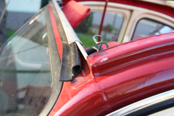

Can some kind person let me have some photos of how the hood front rubber seal and cover is fitted

Found this picture, first the rubber is put in with the lip pointing a bit upwards, then the aluminium profile is pushed over it. Straight edge to the front. Hook it over the rubber and force the lot backwards over the body edge.
