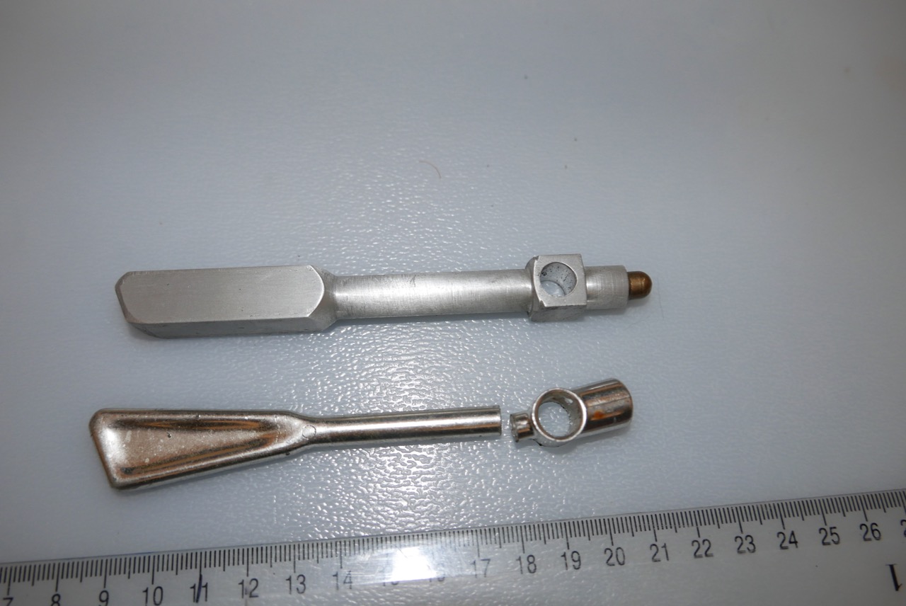

Have broken 3 indicator stalks....
So I made a new one from a piece of square bar.

Probably next thing broken would be the switch casing itself. :mrgreen:
Aluminium isn't ?

Piece of aluminum scrap.
Breakage may happen, but I believe the items fitted to Dyane's are the same switch but with a metal shaft

Got a Dyane stalk fitted to the 2CV indicator switch. Works very well, as the Dyane stalk has a slight kink that moves it a bit closer to the wheel.

Love the alu one. Beyond my skill set, might check out this Dyane option though. Thanks guys.
