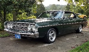

OK, it's 35C, I'm in a drive thru waiting for food and my 68 Ford starts idling rough.
I restart the car but it stalls again and won't restart. I coast down to a car park. This makes the second time this has happened with this car in the past 20 years. Last time it happened I was at the ATM at my bank.
I ended up having to have the car towed home. After it cools down it restarts. Hesitates a bit until the fuel bowel refills with petrol.
