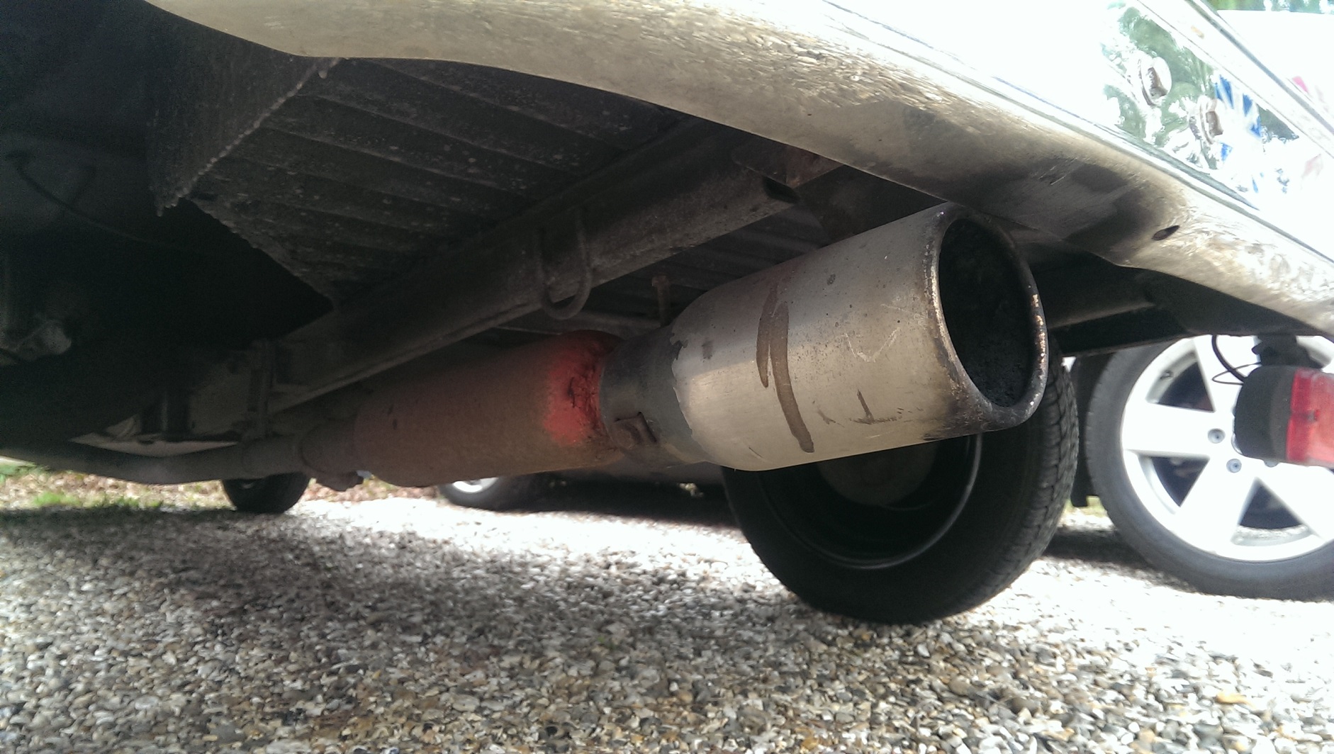

I have on my car a section I got fitted by Louie Barbour some years ago, to replace the swan neck/crossbox bit.Its good, I like the feel it gives the car, almost seems better up hills and stuff. It looks like this:
http://www.ecas2cvparts.co.uk/into-perf ... -1436.html
The only trouble with it was it sounds like a bag of nails at certain revs. To counter that, I decided to make it MORE noisey but in a nicer way, and put a cherry bomb on the back of the exhaust.
Its fun, but bloody hell is it noisy. The cherry bomb is starting to rust now and i'm almost relieved, but if I replace it with normal bits I'll have the bag of nails noise back again.
So my question is, has anyone any experience with these kinds of exhausts that replace the crossbox/suggestions on how to make it sound nicer?
Pic of exhaust. (Also with giant funny end piece which I found on the road and looks hilarious on the car.)

Ah so you've got just the one silencer there. I've got the original style in the middle, running down to the cherry bomb at the rear.
You've got just the one, thats cool. My middle one isn't ready for replacement, still looks new. I wonder if I can stick a Mini one like yours on the rear.
