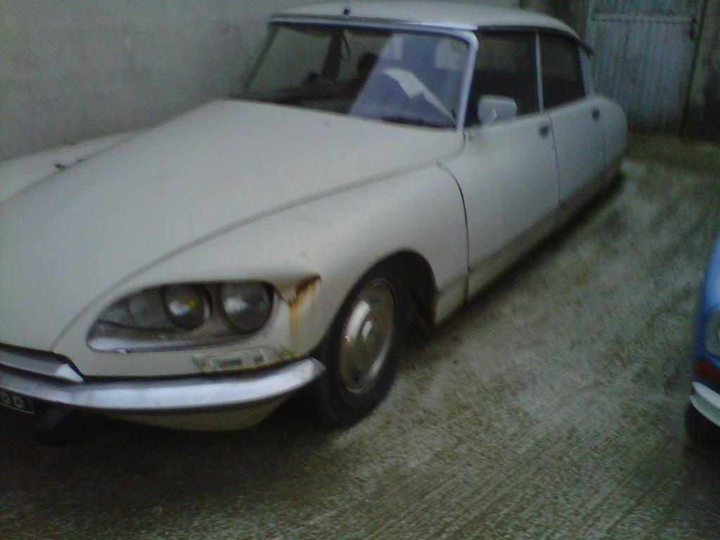

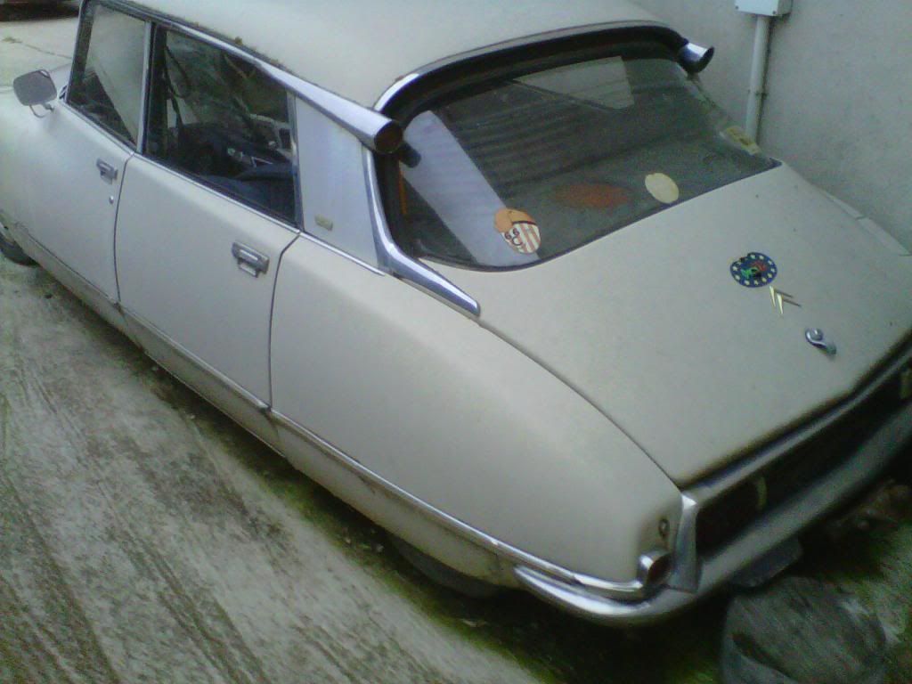

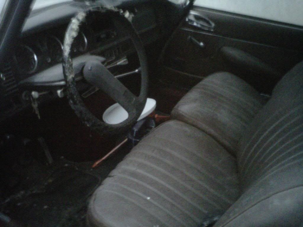

from the shady pix the guy sent me there looks to be not much rust, but I´ve read that the sills and boot are the place to look. there is a chap locally who has one also so I guess he´d be a good source of local contacts etc.so on a scale of 1 to 10 (10 being impossible) how hard would you rate the mechanicals to fix at home??
heres a pic of the thing

I have had several ds'es over the years, Looking at the pics it is a pallas (which is the most luxues) version there is and it has a manual gearbox....
See it like this if you replace the clutch in your 2cv it is a 3 hour job, in a DS it will take you 3 days... (I've done it a few times so I now what I'm talking about)....
Maintaning a Ds cost you 5 times the money a 2cv will cost you...
But they are übercool.....
They will be very hot inside too (in Spain) because the engine is almost at your shoes...
Take a got look at the sills (behind the cover plates) outside, the innerwings at therear.

Roof itself won't rust - it's fibre glass. BUT, what it's attached to will certainly rust. ie the frame.
Whip the rear wings off, you can see the bolt at the back near the bumper. You can then assess the rear half rust.
