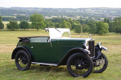

I'll probably be looking for a road legal or easily restorable 2CV or Dyane over the winter once I have room in the garage. It would not matter if it was a bit scruffy. Anyone want a very nice 1931 Morris Minor open tourer........? See pic attached (sorry its not a 2CV)
