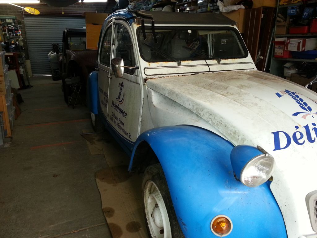

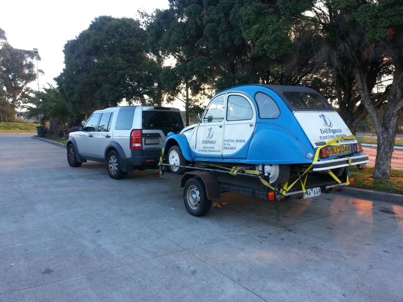

Definitely a pseudo charlie.
The Road Fund Licence expired over here at the end of September '97 - so it could have been exported at some point after that date or indeed between the time it was last taxed over here - either September '96 or March '97.
Have you checked the colour of the 'shell? Perhaps peeling back the fuzzy felt around the body sides or looking under the dashboard.
August 28th, 2013, 1:46 pm
Joined: January 15th, 2013, 12:54 pm
Posts: 12
Post Re: The old identification question
Thanks Neil. Under the dash, on the back of the firewall (scuttle?) is a sort of orangy colour, as I said above, not unlike the Wurth stuff visible in Steve Hills website. There are traces of the same orangy colour peeping through on the engine side of the same panel making me think that it's been replaced or at least repainted.
The rest of the body, at least to the cursory inspection I've been able to do so far, appears to be pretty much consistent with the blue and white scheme.
