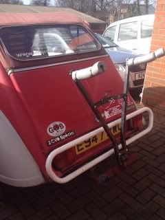

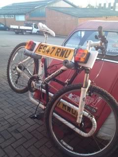

DSCF4578 by 2steamhorses(Bob), on Flickr
DSCF4580-001 by 2steamhorses(Bob), on Flickre
These two shots show how i used a standard boot type cycle rack with a panel supoort in the boot, the write up can be found if you search 'How I fitted cycle rack' The full set of shots are not available as they are on my external hard drive, which is in Uk while I'm in France.Hop this is of some help :-)
