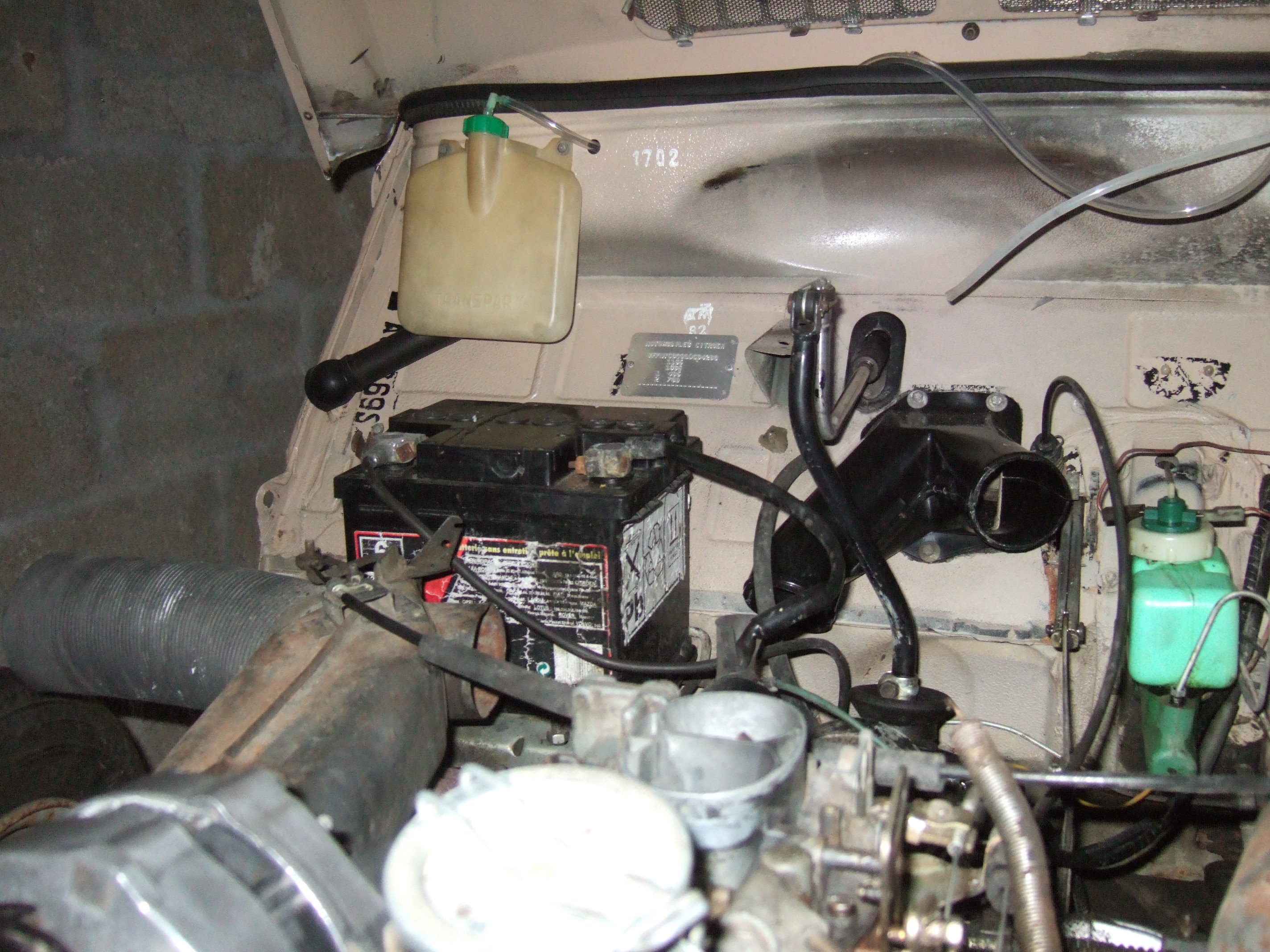

Does your van not have the 4-digit ORGA or RP number stenciled on the bulkhead?
According to the RP number on my old Acadiane it was built 7th July 1981. If yours does have the number pump it into this calculator:
http://www.citroen-ds-id.com/gen/Gen_Organr.html
I'm sure someone will be along in a moment to tell me otherwise, but I always assumed that all Acadianes had the shelf in the locker.

If you're meaning the 4-digit number in white beside the washer bottle then i don't have one there. could it be anywhere else? (Not that i'd find it easily - my bulkhead has been black with dirt ingrained into the stonechip paint stuff since the day i got it :roll:)
