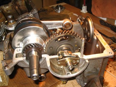

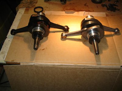

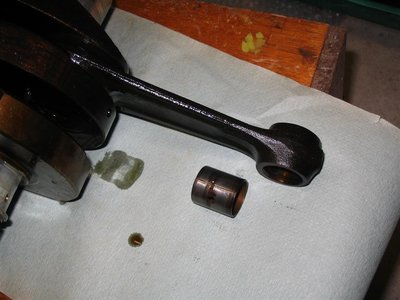

Didn't take photos of the 2 first cars, suspension and gear box job but here are some from Viking Van getting a new crank shaft, the small end came off.

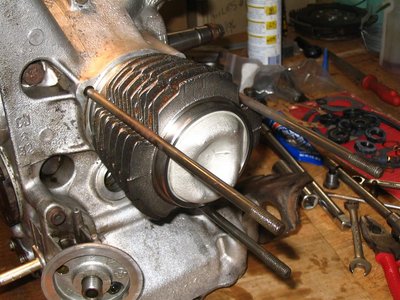

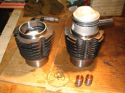

Fitted new piston and cylinder set 9:1 ratio as vans should have.
