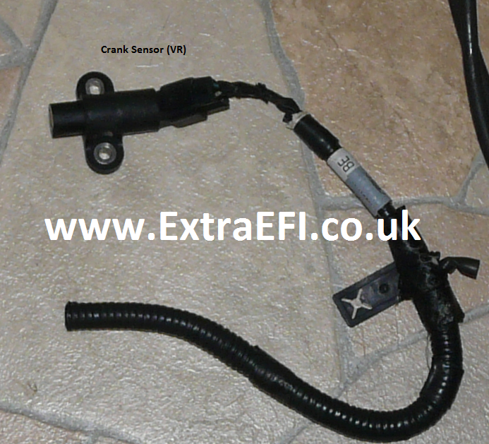

@subarupete: what do you mean Ford VR sensors?

Post Re: New member... from Greece
Ford VR sensor
also see ebay
