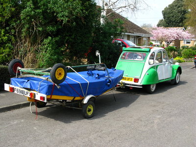

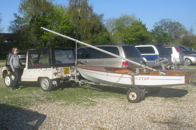

In my experience, towing is excellent with a 2cv. I barely notice the difference. With a well balanced boat/trailer, I've never really felt any difference in handling at all. Cornering is still great, as is acceleration and breaking.
My dad tells an excellent story of how he towed an AKS400 30 miles with a 1954 ripple... apparently the going was slow but steady!
The yellow dinghy behind my 2cv is a 10ft Mirror Mk III Explorer built in the 60's weighing about 400kgs. The boat behind the Mehari is my Girlfriends 1970 Miracle - 14ft, about 300kgs (its significantly sportier than the Mirror).
