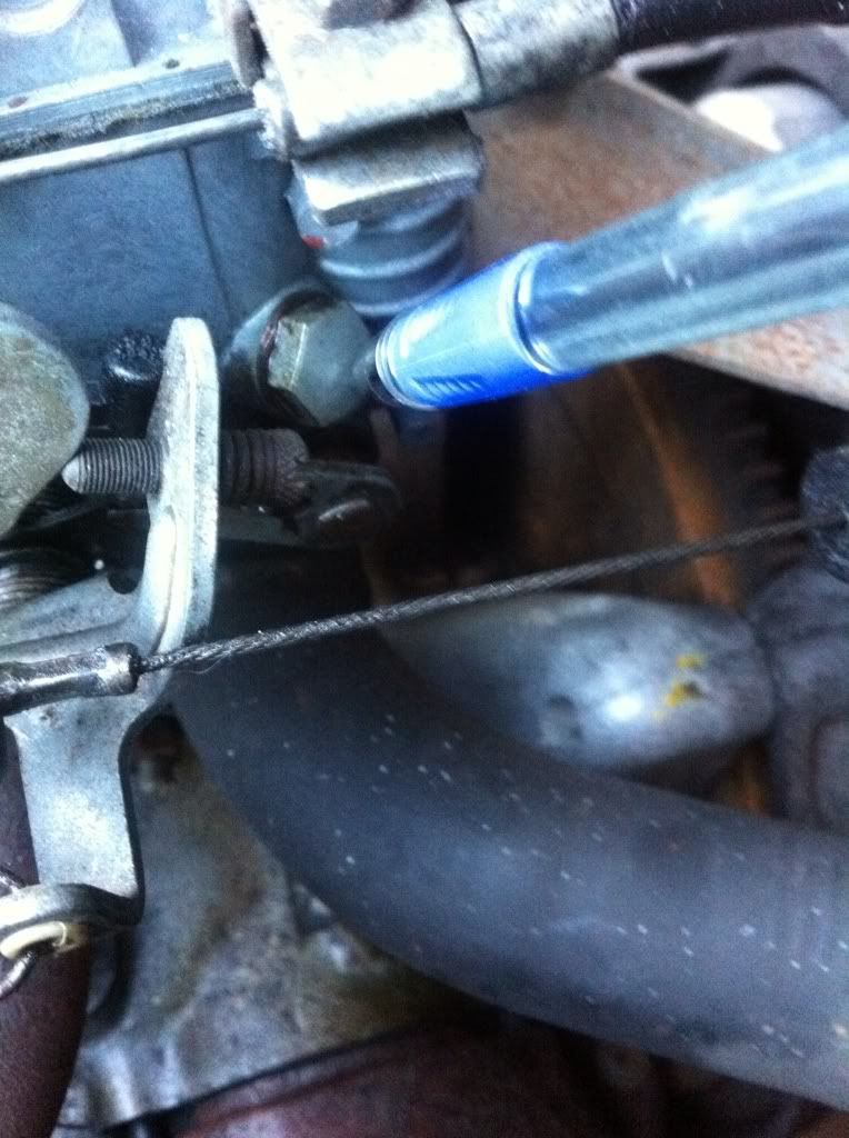

Take this bolt out,and the jet is inside here.Trouble is,its sunk deep inside the body of the carb.If you can get onto it great,if you can undo it,even better,if you can keep it on the end of a screwdriver,your a magician :lol: :lol: :lol:

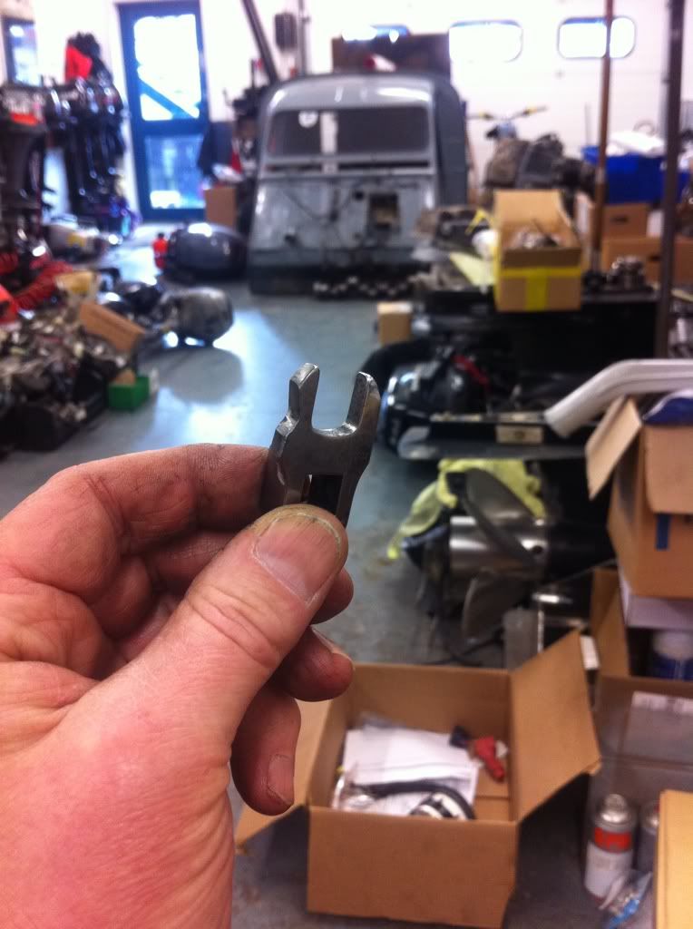

Get youself a 13mm crowsfoot and grind the sides to make it fit,easy peasy ;)

James 2 barrel carb the primary is the front smaller one the secondary is the rear one .
Fuel is drawn in by the fast moving air stream on a big bucket carb at idle the air would hardly be moving and so metering the fuel would be difficult - if you have a small carb then the engine cant get enough air in at top revs , so the twin carb was developed the second carb opening up in the last 1/3 when the main carb starts to sun out of puff.
economical at low engine speeds not restrictive when you give it the beans.
If your re jetting the carb its the jet in the RHS as you peer in the bonnet opening - you need to go in through the "Drain Plug" on that side. and you only need to take the lid off
TOP TIP
BnQ sell silly "Hi torque" spanners there is a 10-12mm one if you heat the bend at the 12mm end you can bend up the spanner so its at 90* to the 12mm ring then take a few mm of the face with an angle grinder and hey ho new carb spanner! you can probably get it cherry red on a domestic gas ring i did mine with a mapp blowtorch
PS13mm crows foot usless as its 12mm af nuts on the newer carbs and they tend to be too thick

Yes Sean,you are of course correct.I meant 12mm :roll: ,what a dick.(me not you)
Heres a pic
Fits the carb on my special and D*lly no problem at all.
