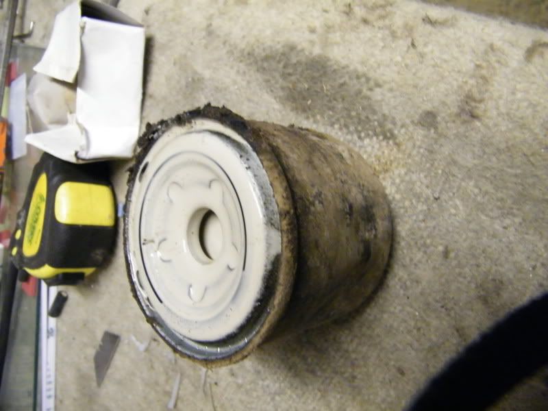

Do you think this might want a head gasket?

or you got very excited when you removed it...

Is that off your van?
Don't jump the gun, the oil cooler tht the filter screws onto is prone to allowing oil and water cross contamination....... :ugeek:

Nah it's off the fork lift. It's always had a bit of mayo in the rocker box but we put that down to it being gas powered and that it's never run for long enough to get warm. I managed to convince my employers it wouldn't hurt to give it an oil change and all that came out of the sump was about one litre of this gunk. It lasted about a week before it wouldn't start and wouldn't turn over, I took the plugs out and one pot was full of water. It's meant I haven't had to do much work this week though. I changed the head gasket and now the starter motor brushes have worn out and no amount of cleaning them and bending things in the top of the motor can make it work properly for long enough to start it until the brushes/commutater burn out. So until the new starter turns up on Monday I won't know if I've fixed the head gasket or whether the head, which I had to weld as it was eroded away above the gasket, is scrap. I love my job.
