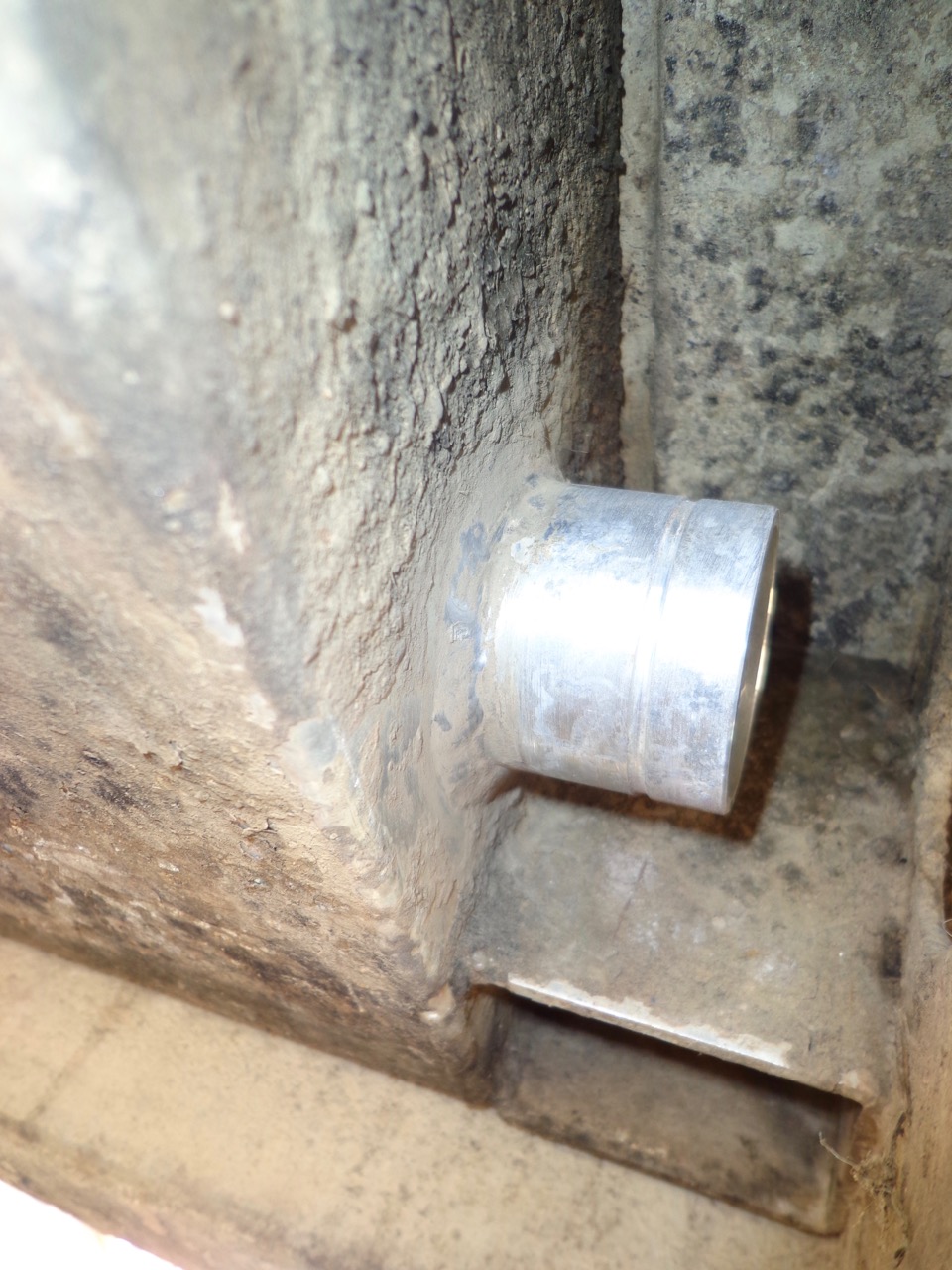

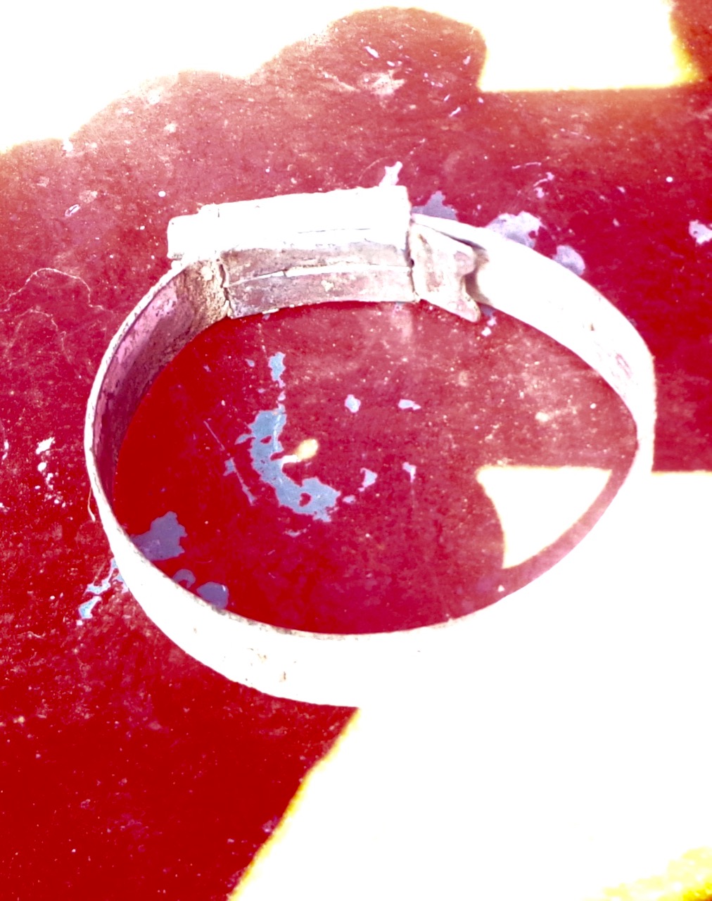

Found the reasons for the fuel "weep" on a full tank.
Old/Tired jubilee clamp and some corrosion of the tank input pipe.
Old Jubilee clamp
Tank Input
New clamp.
These give an even tension round the whole clamp and are designed for fuel pipes etc

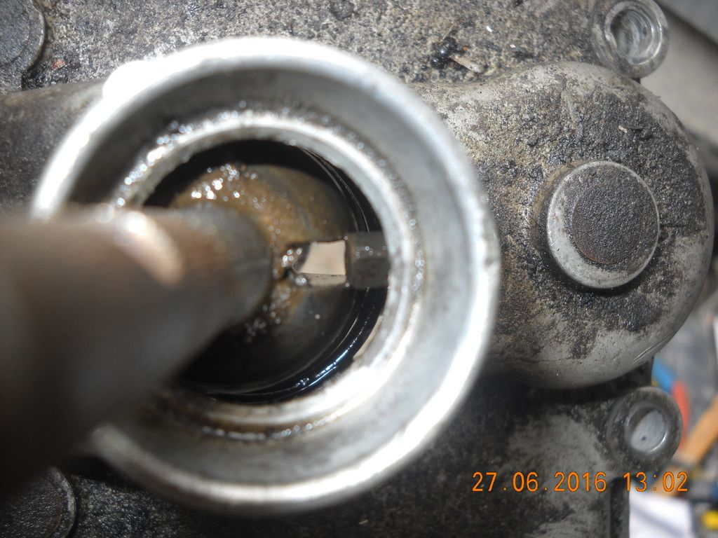

A friend called some days ago, and said her Dyane lost all but not first and reverse gears. I was very excited to see what could be wrong and make that situation. Quite soon the issue was find, but I have never seen that before...
This "ball" on gearlever was jumped out of flat stud, and because of that the gearlever didn't move like it should. Rotated that flat part a little, and the "ball" went back to right place, and after that everything works like it should...
Has someone seen this happened ever..?

Hi Jasu,
the only time I've seen it was during 2CV racing, where the pilot was rather 'excitable' or did not have that much experience of driving an A series Citroen.
At least it's an easy fix, or it is once you've figured out what had gone wrong... :)

Ken, yes, most of the time were to find what was wrong, and after finding that it was repaired in some minutes. If I could even imagine that can be possible, I wouldn't get the gearbox cover opened at all, but when it was opened it was easy to check some other possible issues at the time...
Yeaterday I had a call from very long time 2cv enthusiast, and he said he had exactly same at some years ago, but couldn't recall on what 2cv he had that. Still not very common happening..?
Now when I know that is possible to happen, next time will be much easier to handle. Need only to remove the gearstick and rotate that flat stud with thin pliers to correct position...
