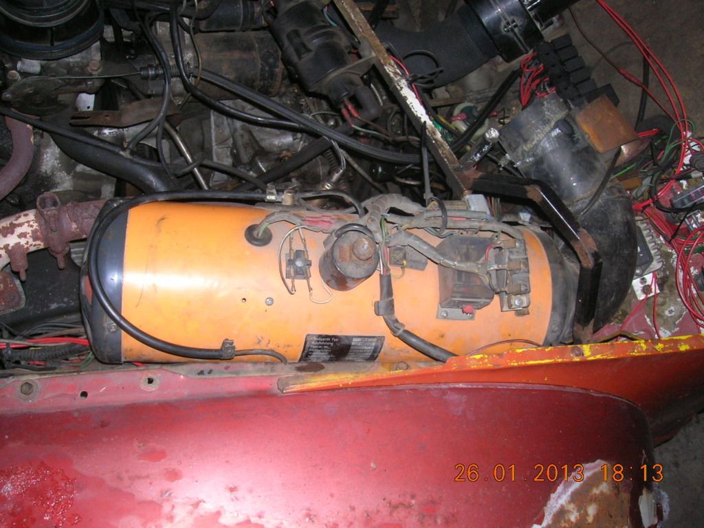

is that a heater you've got mounted under the bonnet? ;)
Air filter box relocated to provide room for it...

ken wrote:
Jasu,
Yes.
The heater is from Kleinbus, quite enough for Dyane...
Testing it, over ten years without use and started without any problems. No computers, no problems...
January 15th, 2016, 1:39 pm

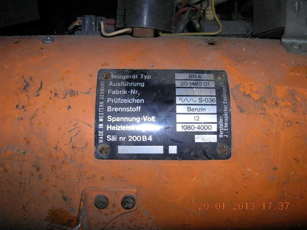

4kW maximum output?
If so, that's roasty toasty... ;)

ken wrote:
4kW maximum output?
It's not kW, something (need to check for sure) Kcal what is near kW if I remember correct. But it make very hot air, and very much, so leaking door gaskets isn't an issue...

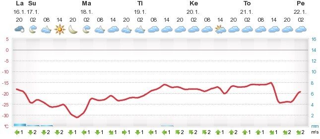

And as you can see from our weather report, that heater is needed now... :lol:
