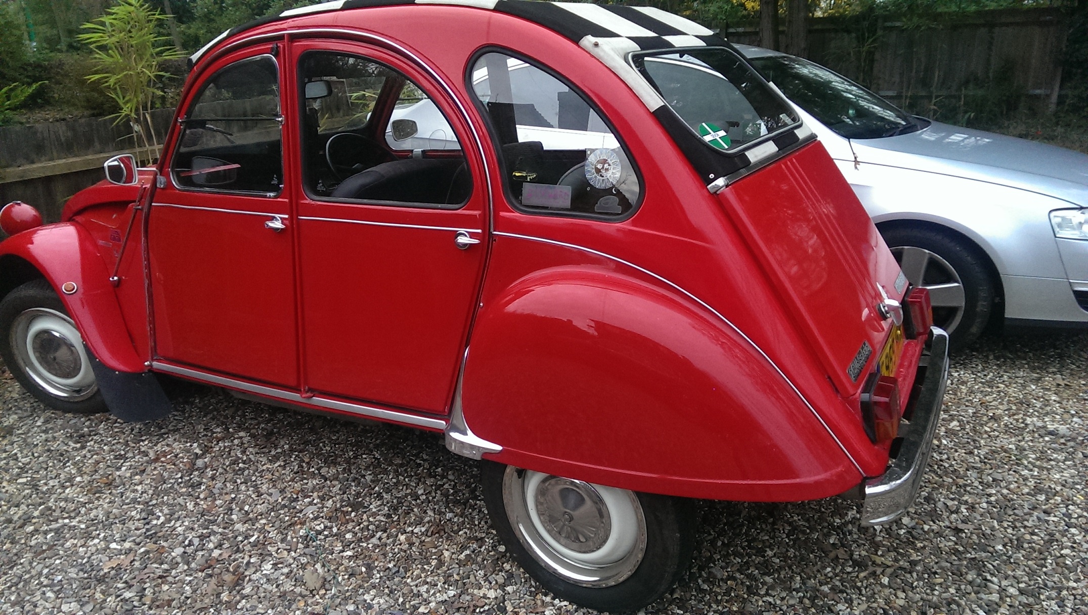

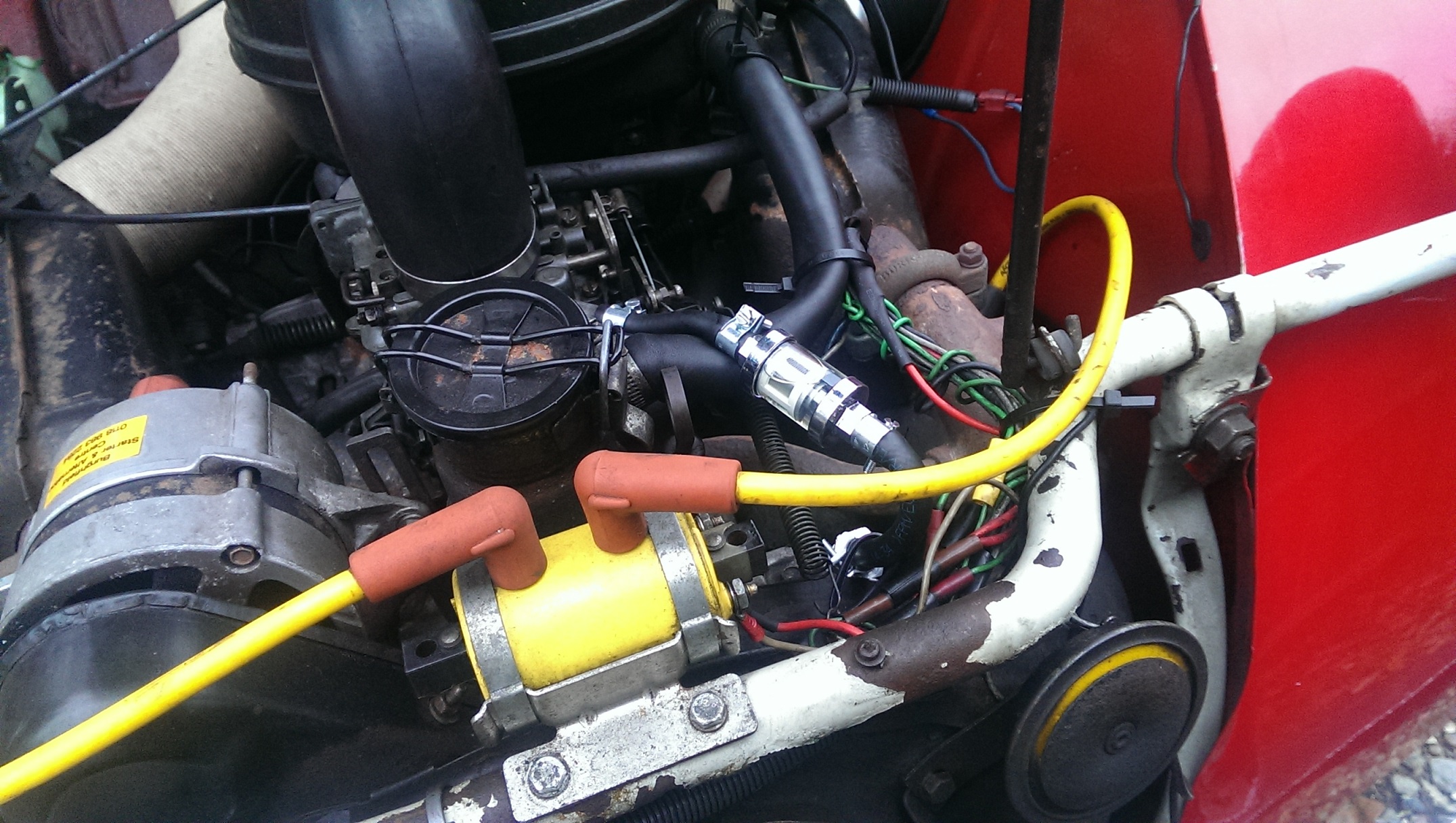

She purdy again! So far from perfect but hey ho.
Also put on some new fuel hose and a glass window fuel filter - fed up with it needing starter fluid spray after a while of sitting. Have one of those one way valves too but that didn't seem to cure it. Pump was new a few years ago, probably worn poppets already I guess. Anyway I will be able to see if the fuel is there or not now.
New gearshift bushings too. Happy little car, I drove it to Brighton and back yesterday, it was awesome :)
December 3rd, 2015, 5:35 pm
Not unknown for that type of ignition coil to short out along the metal clips holding it in place. Many people who use that coil secures it with plastic cable ties.
December 5th, 2015, 2:07 am
Posts: 1294
Thanks. Yes I was thinking about putting heat shrink on them or using rubber spray to coat the brackets. Bit too close aren't they.
