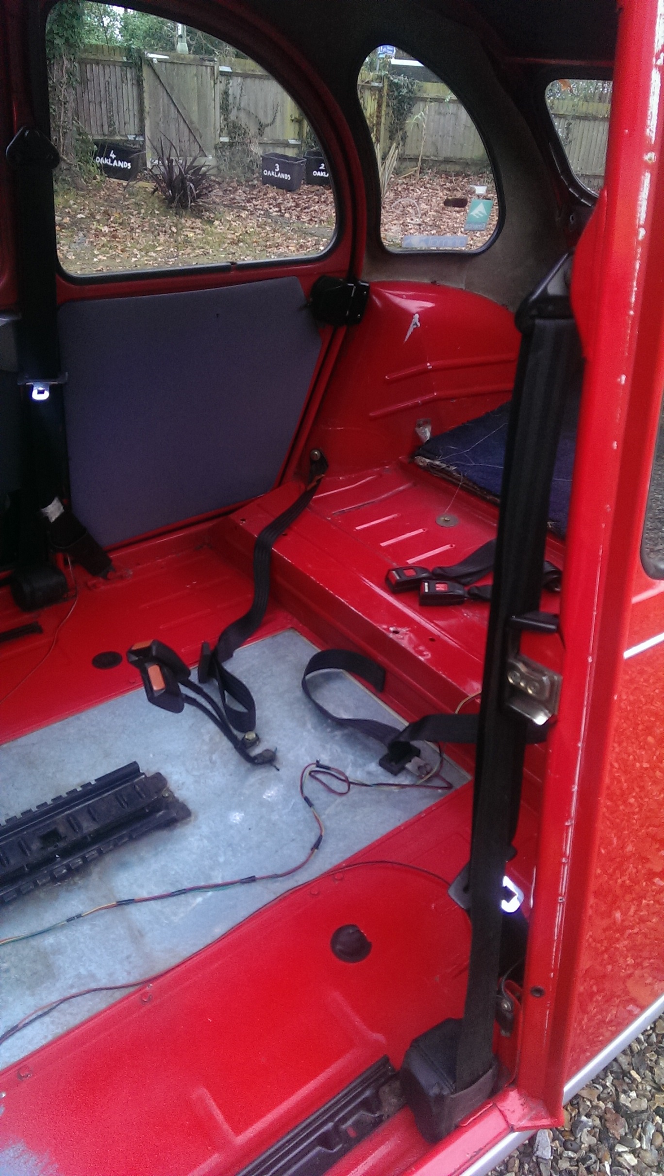

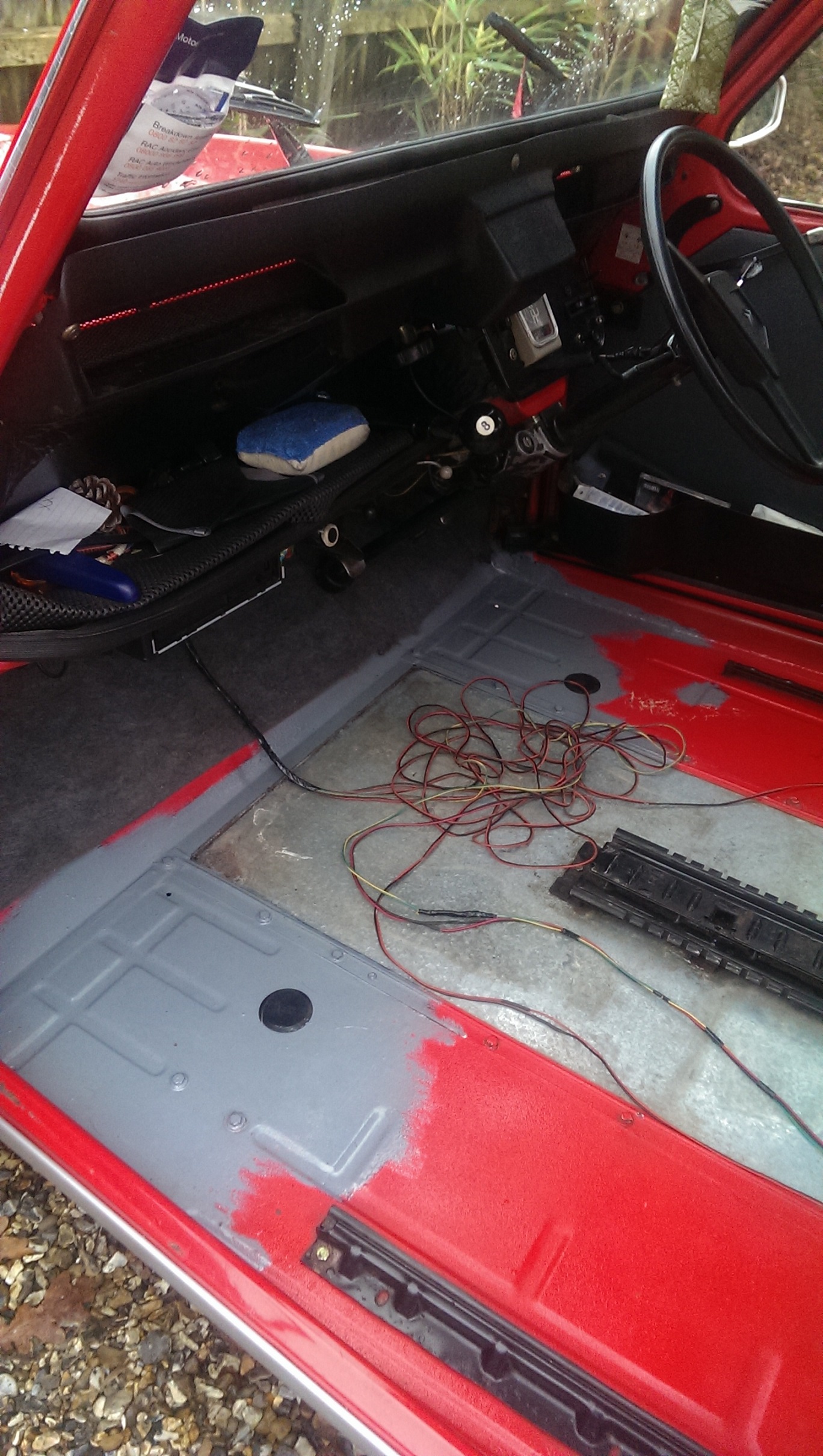

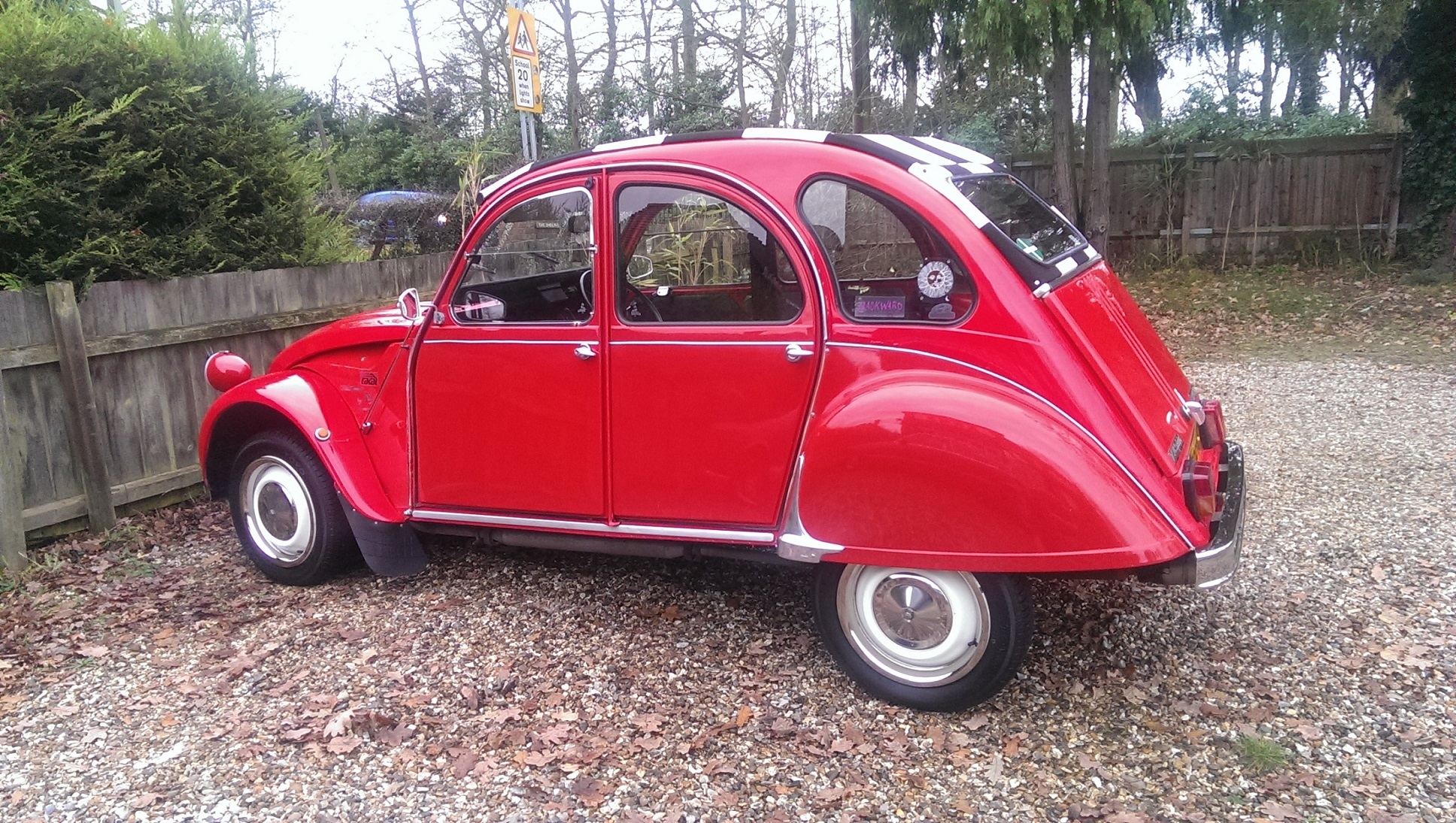

Time for the annual insurance pics. I hate that, but its come up nice after being pretty much neglected since August. A good few hours of cleaning though to get it back to normal.
Poor old thing is still in need of paint after I managed to microblister it all with a very hot pressure washer. Grrr. Its still purdy though :)
Finally got around to the front floor, it was so nice and shiny before but eventually the usual water ingress resulted in the paint going all dark and a couple of blisters showing :(
Anyway ground it down, washed it off with Bilt Hamber Deox-Gel, treated the remainder of the surface rust with Hydrate-80, then painted it with POR-15. Should be good for a good long while, I'll have to find some matching paint to coat it with.
I also drilled a couple more holes in the front floor to allow any water out. I did drill a couple about three years ago but I should have done it way before then and the rust wouldn't have happened in the first place.
It doesn't leak a lot, just a little in the rear door hinge area I think, and then it dribbles down to the front under the rubber matting. It did leak a lot through a rusty vent flap which I replaced, it would fill up with water though!

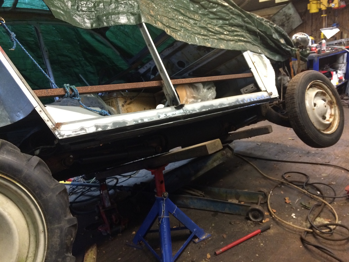

A little panel beating (literally)

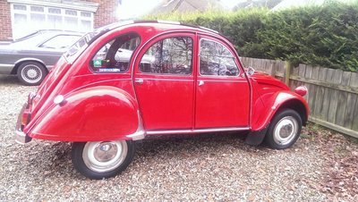

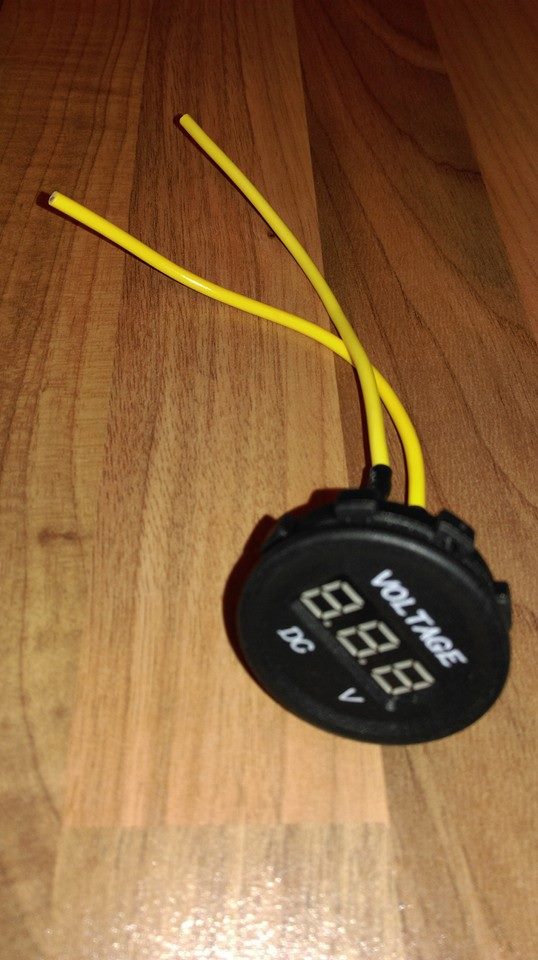

Some goodies came for mine today
10846464_10152607447576245_1625884346808861845_n.jpg [ 81.73 KiB | Viewed 3477 times ]
1988 2CV Special
1969 Singer Chamois

Ian,
are you sure that those holes are...
1/ in the right spots?
2/ big enough?
After fitting new floors, I usually park the car on level ground, pour some water into the footwells, then drill through with a 10mm bit where the water sits deepest.
Also, bashing a tapered bar (aka 'podger') through afterwards will form a nice 'drip' on the underside. ;)
December 18th, 2014, 10:41 pm
Posts: 1326
Ken, great tip about bashing a bar into the holes, I may do that.
I think they are in a good place. I've left the seats out and since it rained I went to have a look to see where water came in. Actually it was bone dry around the door seals etc but for some reason water comes in the drivers side at the bottom of what passes for a a B pillar. Odd eh.
My car was badly vandalised years ago though and was tipped on its side. The top of the channel the door slides into is a bit misshapen, maybe that's why. Perhaps the bit where the gutter meets the body is a little split, I can't tell.
