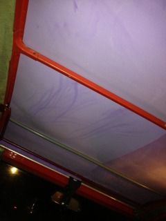

After talk of people lining there roofs. I found some camping mats that I wasn't going to use and came up with this.
Not my finest work but if it works then it will do

You should notice a difference. I use 8mm foam to line the roof in winter and when its icy out there is still ice on the roof after I've been out for a drive so the heat is staying in the cab.
Another tip for those who don't have back seat passengers is to put a board or something behind the backs of the front seats. Cardboard would do I suppose. This will stop the cold air from the back of the car moving to the front under the seats and also mean that any warm air pointed at the floor will have to stay in the front.
Must take some pics of the other Raid Laponie mods. We had -25 outside and +25 inside!!
