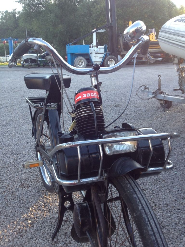

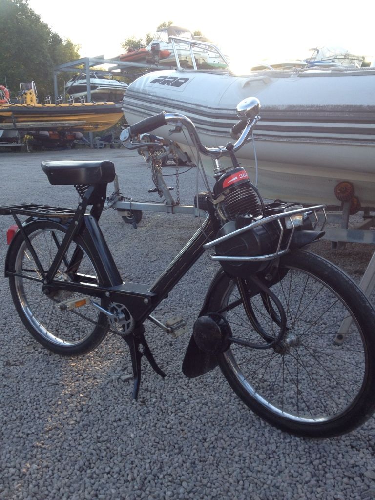

Well,here it is.
I fitted a cable for a rear deraliur onto the throttle,works really well.Adjusted the front brake,and the rear,they stop you much better now.
Just wondering though,how do you tell if the throttle is opening fully and is there any idle adjustment on it?I took the air box off,and when you look down the inlet with the throttle closed.it appears that you can see right down the inlet,then as you open the throttle,a barrel starts to close off the main inlet.When I have it at full throttle on the handlebar,the hole is only half open/closed.Should it be closed completly?
