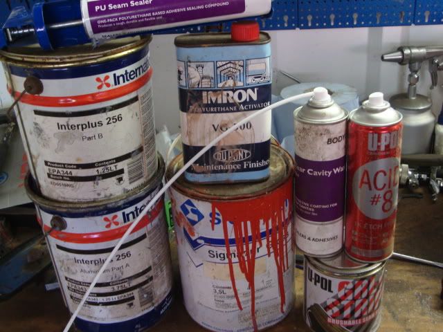

any particular product you suggest?
this is always going to be a split opinionated topic, but personally im for preventation, (at least trying) so long as it is not going to cost more than to replace!
This is a selection of what I've used on my last several projects.
Left to right:
Two part high build zinc primer. As used to paint the old iron railings on Cleethorpes seafront! Mix the two parts together and apply with an emulsioning roller. Goes on like silver gloss stonechip with a dimpled finish.
I've never had to buy any yet as I had quite a bit. This is my last tin and it's about half full. I dread to think how expensive it is but it's bloody good stuff.
Should be available from an industrial paint supplier if it's still legal.
Two pack polyurethane gloss. Again it's mixed with the activator and I've usually applied it with a roller. Goes on nice and thick and stays flexible. I've used it on inner wheel arches and underneath and it has never chipped at all.
Available from any industrial paint supplier. No idea how much though.
Bodyline cavity wax. 500ml aerosol is fairly cheap from Brown Brothers and comes with the extension probe thing. It's really thin so it soaks into everywhere. Admittedly it makes no claims to convert existing rust like Waxoyl but on new panels (inside of the sills and the like) it's great. Piece of cake to apply too. None of the frustration of a Waxoyl sprayer/buckets of hot water/gallons of white spirit scenario. It's also fairly whiff free too.
Upol acid etch primer. Brilliant on bare metal and newly welded seams before using seam sealer. About a tenner a tin from most paint suppliers (or even Halfords).
At the bottom on the right is brushable seam sealer. I've never been that fussy about the brand I use. It all seems as messy as each other.
And on the top is Bodyline seam sealer for use in a cartridge gun. I use on mire visible seams. Inside the boot where the wings meet the boot floor, or inside where the floor panels meet the sills. Much tidier than the brushable stuff. Again it's from Brown Brothers and is surprisingly cheap.
I must add the I also always have a tin of Waxoyl hanging about in case I ever have to put something on some rust that cannot be removed for whatever reason. I've long since given up on trying to spray it in cavities though.
